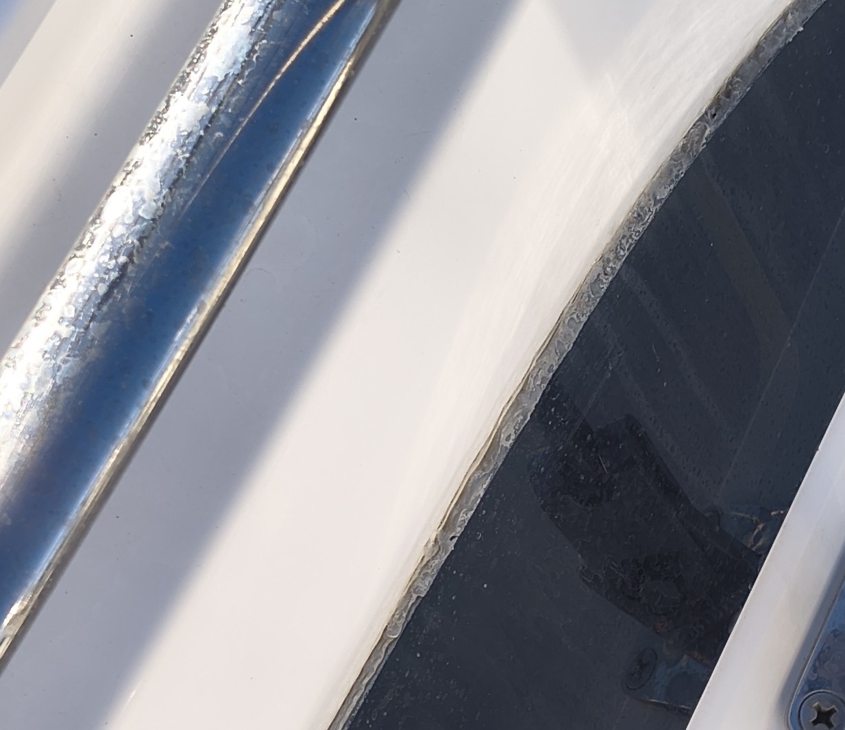

After 26 years the bonding silicone on my "sun exposed" side windows has failed and they are leaking. Trying the easy way to seal with Sikaflex 291 didn't wokk as it didn't stick to the acrylic window so I am now preparing to remove the windows fully and do the job properly.
It appears that use of double side Very High Bond tape is now in routine use and potentially a lot less messy than bedding the window against a bead of silicone. Has anyone used VHB tape and how did it go?
