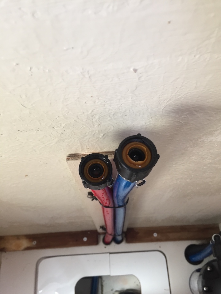

replaced the faucet for the galley sink this past weekend and of course the fitting for the hot side connection starts leaking at the crimped connection... has anyone had any luck repairing/replacing these fittings? I can't find anything on Catalina Direct on these...

Hey Jason. Did you ever find this connector? I have a similiar problem. After commissioning the boat from the winter storage and filling the water tanks, the conection under the galley sink for cold water feed from the stern tank broke. I'll try and attache photos, but if you found a place to order/obtain the, can you let me know? Basically I need exactly what you have the connector you have in picture (female on one end to connect to the inline shutoff and the other end ridged to slip into the hose from tank)... I'll try and attach pix...

From your neighbor to the south. I am trying to add a Tee in the water supply to support a compression fitting for a filtered water spigot.
Do you know what kind of thread is on the supply lines?

I'm going to answer my own question. It is 1/2 in NPT.
Now I am trying to determine whether the hose is standard 1/2 Pex or some other size?
