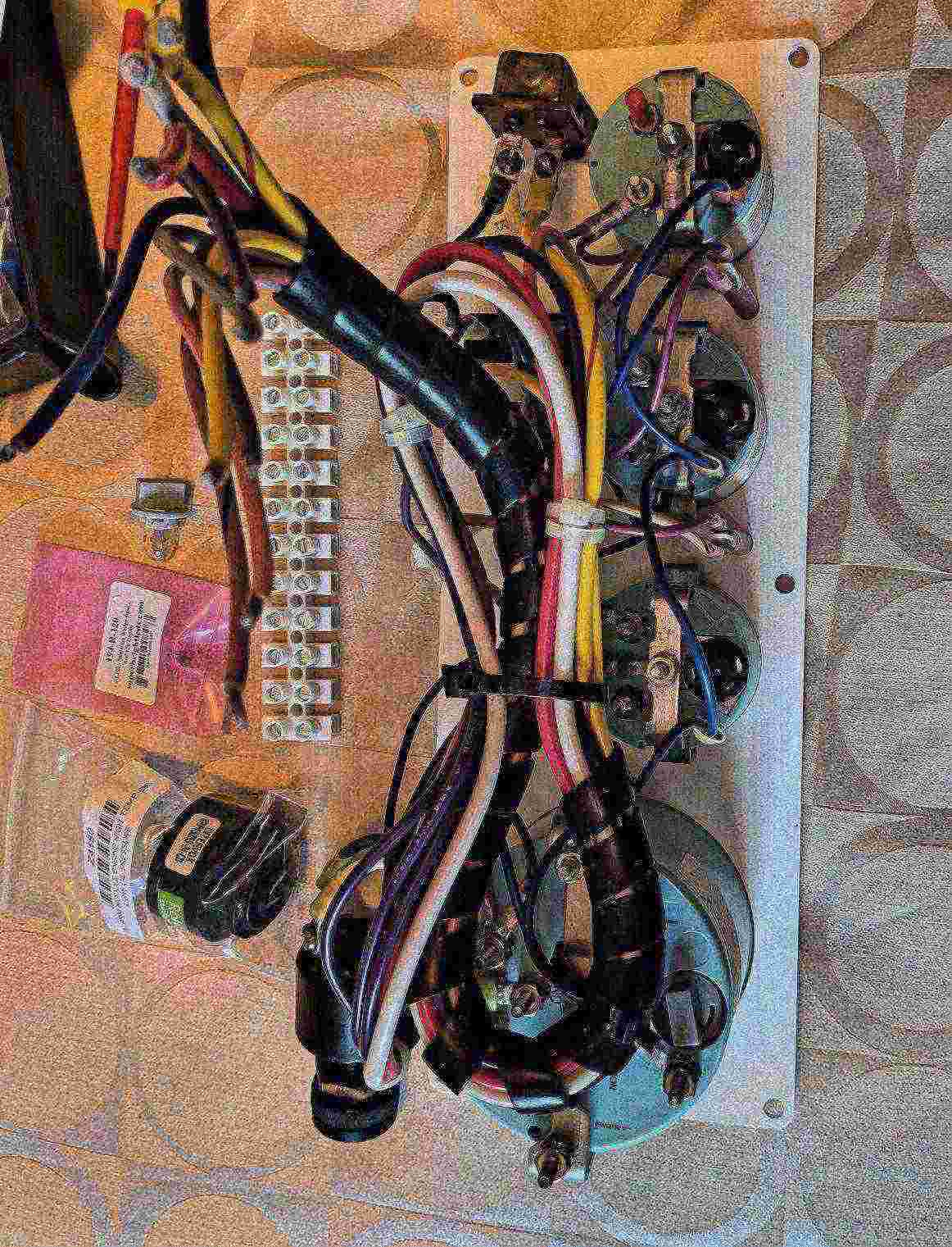

The switch is if I recall from memory, a normally open circuit and when overheated it grounds the path of 12V -> LED -> buzzer -> switch -> gnd. If the LED and buzzer are individually ok (check with a 12v battery and a + and -wire to either side of the LED and buzzer when disconnected) and then if the wiring checks as good with an ohmmeter then the switch by elimination must be the problem. I had a similar issue and used this methodology to find that the buzzer which is essentially two buzzers in one three terminal block (+1 temp +2 oil pressure and -ve/gnd rtn) had failed on the overtemp side and so when I had a problem when motoring out to go sailing, I just got an illuminated overtemp LED and also from the other sensor a pegged temp gauge. I fortunately noticed this fairly quickly, killed the engine and sailed a bit then it worked OK on restarting after it cooled down.. I checked everything afterwards, it had only briefly overheated, no loss of coolant, no signs of any change. I read that if an overheat is severe it does lead to permanent damage immediately and it normally shows as increased oil consumption or heavy smoke (damaged rings) or loss of power and weeping/leakage around the cylinder head due to head warping. You probably dodged a bullet.
I couldn't work out exactly what had happened, I always check at the dock to ensure water coming out on initially starting, so it was working, there was no damage to the raw water impeller or housing. I checked the thermostat a few times in a saucepan of boiling water to ensure it was working, no problems. My best guess was that I sucked a plastic bag or similar junk across the engine thru hull that fell away when the engine was turned off and sailing.
Checked the inlet strainer, changed the oil, changed the thermostat, changed the impeller and fitted a new buzzer and cleaned all the connections and also changed the horrible connector strip ($12 at Catalina Direct, they also stock the buzzer). At the same time I changed the worn engine panel (new enameled metal plate bought from someone who made replacements on this forum), the whole job was very time consuming, maybe 10 hours.
