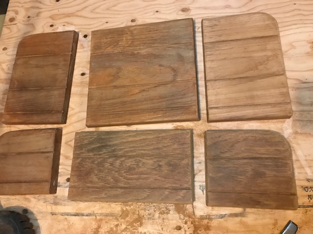

I am trying to refinish the steps on the cabin ladder of a 2007 Catalina 350 and would like any advice you can provide. I removed the steps from the ladder and I stripped the old varnish off with a heat gun on one of the pieces. It seemed to darken the wood a little bit. Some serious sanding brought back what looks like the original teak, but it doesn't look much like the varnished sections. The varnished pieces seem to have a light orangish color compared the the light tan teak. What type of varnish finish is on the Catalina interior teak? Would a chemical stripper such as CitrusStrip remove the varnish without making the teak appear darker? Nearly any kind of finish (oil or varnish) will slightly darken the wood. Is there a good way to lighten the teak before applying varnish so that it comes closer to matching the rest of the interior?
- Stair Step 2A.JPG (27.77 KiB) Viewed 11114 times
- Stair Step 1a.JPG (36.8 KiB) Viewed 11114 times

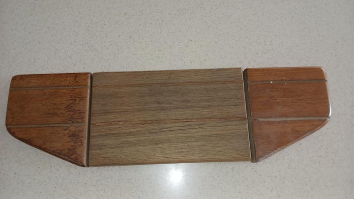

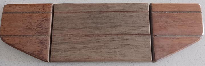

I think you're right. I don't see how I could get the base teak that is generally greyish to ever come out close to the lighter almost yellowish color of the original steps and table and everything else in the cabin. It's pretty hard to match 14 years of yellowing varnish. I could lighten the teak some with teak brightener and maybe test stain the back side of the steps to get closer. Or, I could just put a clear varnish on the base teak, that could be close to the teak on the flooring which is a little darker than the table and everything else. The steps would look beautiful, but just not match anything in the cabin. Maybe just fill the groves in the steps with yellow caulk and they would match the teak and holly flooring?
- Stair Step 3a.JPG (48.36 KiB) Viewed 11095 times

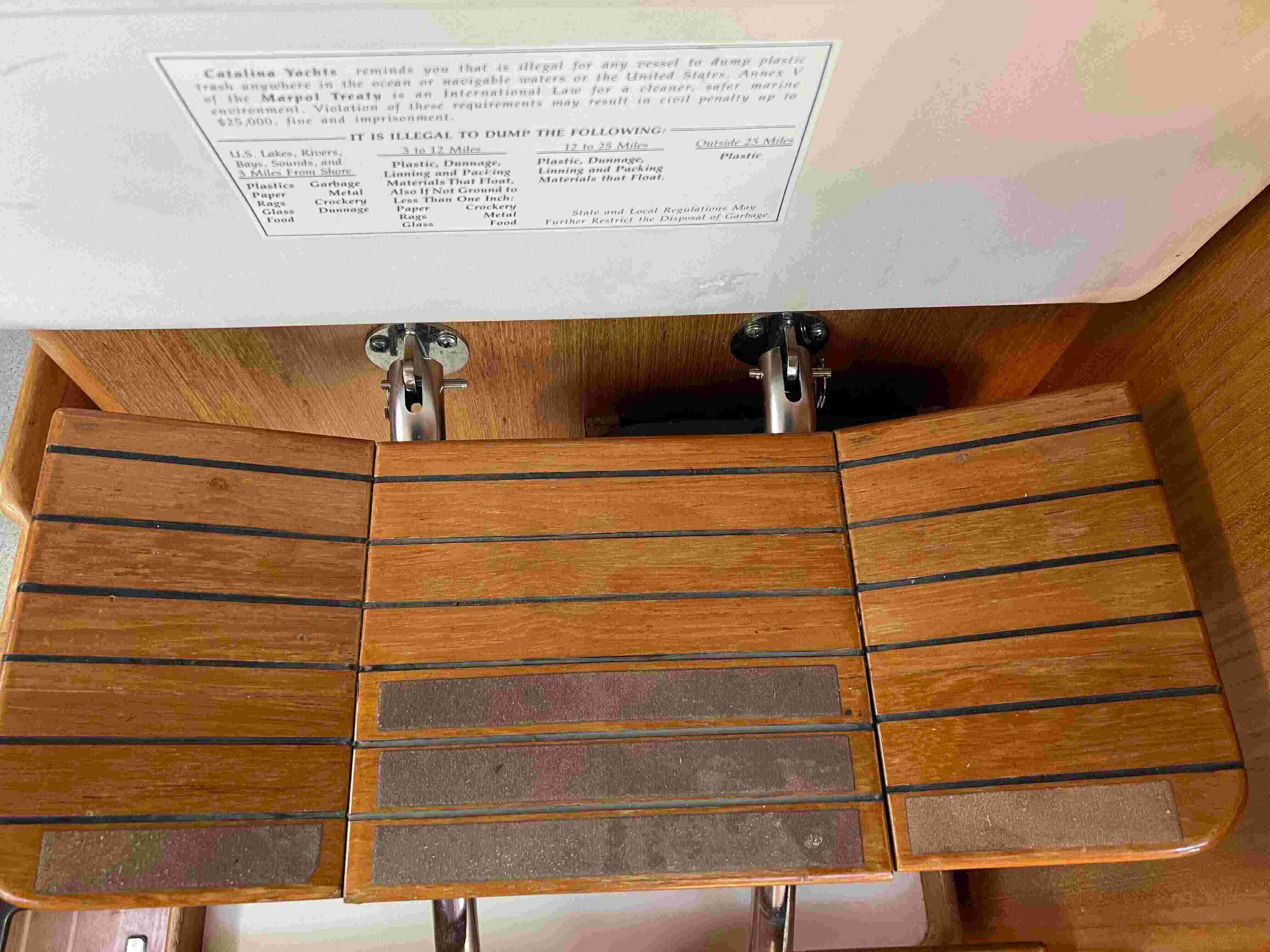

I'm heading back to my boat next week so I'll snap some pics then. Your assumption is correct - I did varnish first and then caulked. I taped each edge of the grooves with painter's tape and then "troweled" with my finger to level it out. Be sure to remove the tape before the silicone starts to set. I added the non-skid tape after a neighbor with wet feet tumbled down the steps.

Here's a couple of pics showing what I did with my steps. The non-skids strips look a bit shopworn and probably need replacement. I also cut some additional grooves in the treads. I didn't like the aesthetics of Catalina's version.
- stair2 (1).jpg (233.11 KiB) Viewed 10980 times
- stair1 (1).jpg (243.18 KiB) Viewed 10980 times
