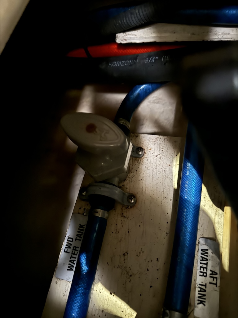

Does anyone have a source of supply and/or a part number for the water supply valves from the water tanks?
They are located under the sink in the galley.

I replaced one of mine a couple years ago, easy job. Got the valve from Ace Hardware online and picked it up at my local Ace. Price was very reasonable so I got 2 and used 1 and 1 spare. Same exact valve and easy swap. I have the spare in hand and it is a Zurn Qest 3/8" x 3/8" globe valve. Yes QEST.
All I did was remove the handle by unscrewing the large hex fitting just below the handle. Swapped it out for the new one and never had to remove the valve body.
