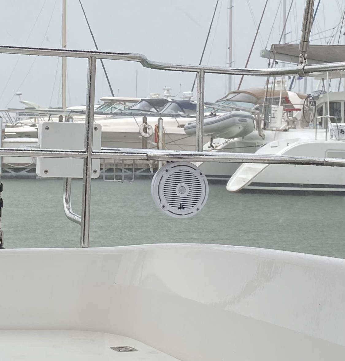

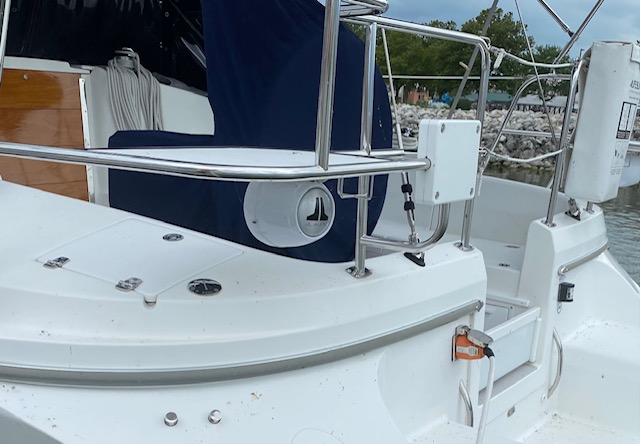

JL Audio makes solid marine grade equipment.
Sturdy polyethylene drivers, solid enclosures. They sound great. The stock Bose were in my opinion horrible. I could not
find better drivers to fit the enclosure and work well. And I looked extensively.
These two ways from JL are made for mounting on ski boat towers. I have had them for 4 years now and hit them with direct pressure streams of water many times. I mounted them with one hole through the seat a single (metric?) screw and washer. Used existing Bose wiring. The seating is not affected (especially with cushion installed.
Next level was the 8 inch subwoofer that I installed with a low power amp in the cockpit side wall opposite the shower sprayer. Had to modify the HDPE “shelf” for the seat a bit.
I can turn it up significantly with great clarity and range. Or keep it low with good nuance and not use much power.
I could find the specific components online for you if needed (amp has discontinued).
The inside I used a quality bookshelf speaker with solid mounting bracket. If you want to know more about that message me.

Thank you everyone for the replies! I have the Bose 151's right now and I'm not a fan of them, I'm definitely going to check out JL Audio recommended by Wisail. I wasn't sure how that style of speaker would look but I don't mind it. Thank you for the picture!

Wisail - I am also very interested in the JL speakers. Can you post the model number, and also a picture of the rear of the speaker showing how you mounted it. I’ve had such bad luck with the Bose that I’m sure I will be replacing them in the not too distant future, and the JLs look like a great option.

https://www.jlaudio.com/collections/mar ... -vex-93402
You can get other grills. I didn’t hook up the RGB lighting but as an afterthought they might be nice mood lighting if you could control them effectively to not mess with night vision and such.
I don’t have good pics of sub install and boat is stored for winter.
JL also has other mounting hardware but my simple single screw was solid and sufficient.
I’m pretty discriminating and have been very happy with this setup!
I also suggest you get a head unit that integrates with multifunction Display (current or future). I have a wireless remote but having it at helm would be the bees knees
I did have concerns about very large wave breaking over stern and punching out the cone of the subwoofer. I cut a piece of plywood and have a bar clamp that reverses to push. Overkill but prepared.
I don’t have any close up of install and JL had since came up with brackets for flat surfaces instead of tower pipes.
Lastly…JL is THE best in the elements!

Wisail - thank you. Very clean install, the speakers look great. Much better than the box speakers on brackets that I was considering. These are now at the top of my list when I replace my Bose.
