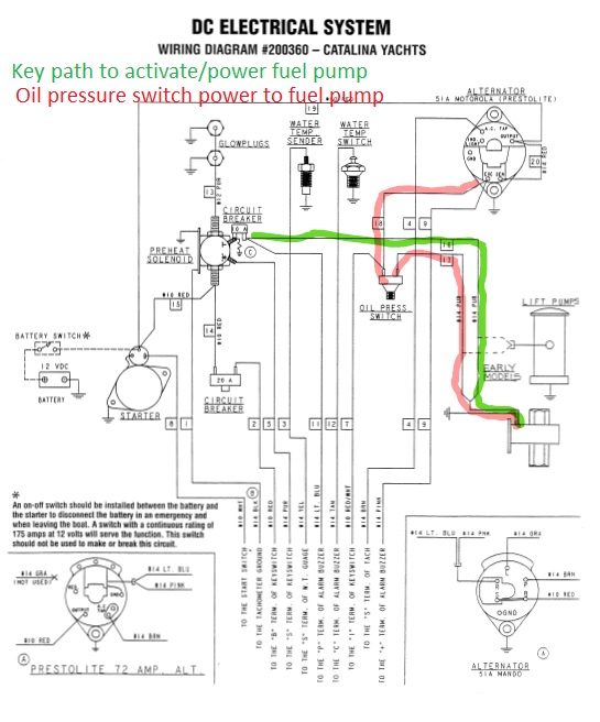

Re: Engine stopped running
Has the oil pressure switch been checked? Turning the key over activates the preheat solenoid and provide power directly to the fuel pump for engine start. That will give enough pressure in the fuel lines to start the engine and keep it going for a few seconds. Once the key is released and you start the engine the oil pressure switch (when it gets to pressure) provides current path to the fuel lift pump to continue its role (idea is that if engine looses oil pressure it will automatically shut down). If a wire is loose/broken or the oil pressure switch has failed I would expect the engine would run a seconds and then shut off.
If the engine starts and runs it is not likely the injection pump has failed. Also the secondary fuel filter on the engine is there to protect the injection pump and that is why it has such a small rating (2 um I believe). Your primary should always be a bigger filter (10 um+) otherwise the secondary doesn't do anything.
Also, is there any smoke when the engine runs or was last running?
Good luck,
Scott
Good luck,
Scott
- Power fuel pump.jpg (94.67 KiB) Viewed 23224 times

Just one correction, different from what I drew, power to the oil pressure switch comes from the "I" on the ignition switch not from the Exc on the alternator. That power from the ignition also energizes the alternator (exc) and provides power to the buzzer for the low oil pressure. If you do hear the buzzer when you start the engine then there should be power from that circuit. So you could rule out lack of power reaching the oil pressure switch as a source of your problem.
The electrical lift pump should only receive 8 volts at this point (check) and should not run (This is the "I" position in the doco). 4 volts is dropped across the buzzer circuit, this is by design. At the 3 oclock called "S" in the doco, the lift pump operates powered by the glow plug solenoid circuit, but only when the key is held in this position. After this it returns to the "I" and the pulse alarm should silence as the engine starts. Note that when you hold the key in the glow plug position, you are putting 12 volts into the P circuit of the buzzer. This is why it the buzzer stops when you move it to this position. IE you have 12v on the + side and the P side of the buzzer (= no voltage diff so no buzzer).on my boat the key switch in the 2 o'clock position energizes the engine circuits as well as the electrical lift pump
Once the engine is up to pressure then the oil switch closes and provides a continuous 12v to the lift pump (and the P term of the buzzer, hence silence).
In essence running for 30-45 secs to me indicates the lift pump operates when you operate the glow plugs, but then 12volts is lost to the lift pump after engine start and you have released the glow plug switch. (So fuel is gradually lost) Perhaps the oil switch has an intermittent failure, or you have a loose connection on the oil switch, I suggest you change it out. (It is a normally open 2 pin switch).
Edit - additional information:
If you pull the buzzer out of the circuit put a quality digital volt meter across the buzzer, it should read 4 volts from + to P. If not put your ohm meter across it. If it is shorted it will say zero ohms and explain why you have no buzzer when the key is in the "I" position. If it fails open then it will be an open circuit. You can also, with the buzzer out of the circuit, put 12v to the + and ground the P. You should then get the pulsing tone (loudly).
If the buzzer works out of circuit but not in circuit, then it is reasonable to assume there is no power from the "I"switch to the oil switch or the buzzer because of a poor connection. Put a multimeter on the output side of the key switch first (should be 12 volts). If so move to the multi gang terminal connector in the pedestal. Needs 12v on the other side of the terminal connector (red/white wire). After that check the other end of that wire at the oil pressure switch and so on.... Good luck.

- Posts: 205
Great explanation, thanks David. I "sort" of understood how that circuit worked, but the way you explained it made it much clearer.
Hi Jim,
My earlier post covers most of the issues re the buzzer. Importantly, with the battery switch on You should have 12+v at the B term of the ignition switch. If you then move to the first detente (2 oclock) you are then powering the engine gauges and the alarm buzzer (IE the key switch connects the B term to the I term). The alarm buzzer should come on at this point and only at this point. You are feeding 12 volts to it's positive terminal and it is being "grounded" via the P term. The P term at this point can "ground" either via the lift pump or the 1kw resistor attached to the 10 amp breaker. The reason this resistor exists is to put a load on the circuit, you cannot attach the P term direct to "ground" as it should still have 8 volts on it at this point. That 8 volts needs to be used up prior to the circuit going to "ground", if you connect the P term direct to "ground" it would be at zero volts and thus the buzzer cannot function (edit: function as part of the circuit meaning it goes from 8v to 12v after engine start).
Complex when you write about it, but logical in electrical terms.
How do you test the buzzer: Disconnect it from all points and put 12 volts on the + terminal and connect the P terminal to the neg of the 12v supply. It should pulse loudly at this point. Likewise you should connect 12 volts to the + terminal and connect the C terminal to the negative terminal and it should give a loud continuous tone. (The P stands for Pulse tone and the C stands for continuous tone.)
If it does not sound it is defective and should be replaced. The problem is you do not know without testing, if your buzzer is shorted open or closed. If it is shorted closed, it will probably provide 12v to the lift pump in the I position. If it is shorted open it will not provide voltage to the lift pump and thus you should lose fuel shortly after start due to the key being returned from the S (glow plug) position to the I position for normal running. (Assuming your oil pressure switch has also failed open as it had in your case with a bad connector.)
I am thinking in your case (and in emergency only, would have killed your glow plugs) you could have held the switch in the S position and the engine would not have shut off!
For everyone, do not use your boat continuously with a defective buzzer, you don't know the electrical state of your fuel pump in this case and how it is being powered, until your wiring fails. If you don't know how are you going to fix a failure. As we all know, diesel engines require clean fuel and clean air, that's all.
BTW I use "ground" like that because it is not a ground. It is a negative path back to the battery negative terminal. It is just connected to it by a dirty big resistor called the engine block. In a nutshell all electricity starts at the battery and returns to the battery to complete the circuit. If anyone thinks they can ground an electrical circuit by connecting the neg terminal to the engine block, go ahead and try it. Disconnect the neg battery terminal and ground any 12 volt load to the engine block or any other ground. Result - complete failure, no such thing as a ground in DC electricity.
Need to post a correction to my June 26 post when I said
BTW I have a spare new lift pump and checking it today shows it has 30k ohms of resistance at rest and uses 1.5 amps when running (no fuel load). So the parallel resistance for the lift pump circuit and the 1kw resistor comes to 970 ohms.
. I need to check this but in examining the circuit again, it makes more sense for the I term to be isolated when you move the key switch to the S position (glow plug). Thus in fact you would then have 0 volts at the + term and 12 volts at the P term. The result is however the same, no buzzer in the glow plug position. Apologies for the confusion.This is why it the buzzer stops when you move it to this position. IE you have 12v on the + side and the P side of the buzzer (= no voltage diff so no buzzer).
