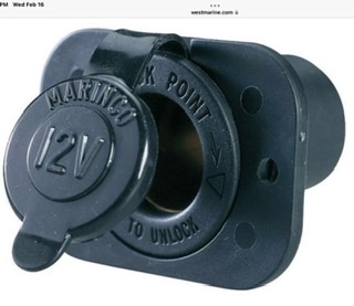

Greetings, I just realized the 12 volt Marinco receptacle on the pedestal is not working. After unscrewing the two screws holding on the faceplate and removing that. The receptacle does not pop out of the pedestal. There is a cryptic printing around the edge of the receptacle, “unlock point” with a large “V”. Tried to find a blow up at Marinco. Which part rotates? How do I unlock it? Will it fall inside the pedestal if I unlock it?
Hopefully someone has used this receptacle and knows the answers.
Thanks, Dana

Front of receptacle
Front of receptacle

So, try accessing the back of the receptacle and if there is a "threaded locking ring", unscrew it.
