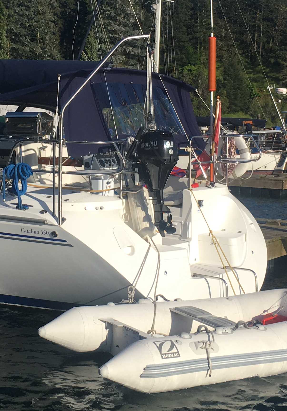

Hello
I also bought a Tohatsu 9.8hp a couple of years ago. It is the lightest one on the market but still much to heavy to man-handle up and down from the bracket.
I had a custom designed hoist built which is mounted on the port side. Its mounted on the transom using an angled flange and is also fixed to the perch seat/pushpit rail. It allows the dinghy to be place either along the port side or across the transom lift the engine on and off.
I didn't like the off the shelf units that are available because they didn't have enough reach to swing the motor all the way over to an "along side" position. The OTS units also come with a 3:1, or 4:1 tackle. Ours has a 5:1 tackle so is easy to manage the weight by me or by my wife.
I'll try to find a picture and will send it along.

by Captain Kirk
Here's a pic. Its constructed of high grade thick wall 1 1/4" SS tubing. It easily carries the weight of the motor.
BTW, last year I sold the old Zodiac and bought a Highfield, its much lighter and rides much better than the heavy fiberglass Zodiac which also had a very flat bottom. The Highfield has a deeper hull and handles choppy water without as much spray.
motor hoist.jpg (188.35 KiB) Viewed 18966 times
