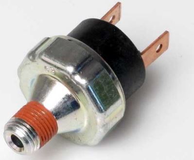

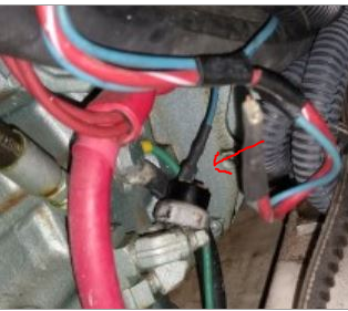

Check your oil pressure cut-off switch. Should be on the bottom left side of the engine about midway back. There are two blade connectors- one is in a circuit with the buzzer, the other to the fuel lift pump. The idea is if oil pressure drops the circuits open giving the buzzer and the engine shuts down. I had the bade for the buzzer rust and break off which opened the circuit and made the buzzer run as it thought there was no oil pressure. I replaced the switch (Catalina Direct) which fixed the issue. It is a bit difficult to get out (but what isn't on a sailboat).
