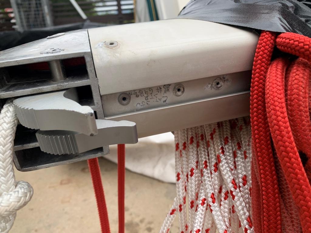

We removed the boom and took it to the workshop for an examination (left the outhaul and two reefing lines still rigged in the boom). Removing the front end cap was the logical approach noting the tangled pulleys are all at this end. To remove it five rivets have to be drilled out. two each side as shown here (The large rivet looking items at left are the sheave and clam cleate pins ):
end of boom.jpg (97.59 KiB) Viewed 5982 times

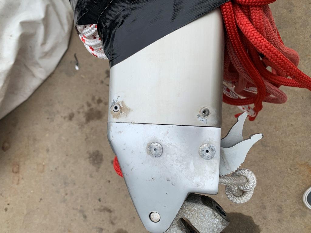

And one underneath, the rivet closest to the end of the boom shown here:
under of boom.jpg (114.71 KiB) Viewed 5982 times
The two rivets to the right in the above picture are part of the problem. They are supposed to hold the retainer ring at front of the boom that the fwd standing line attaches to (part of the pulley system.) After removing all three rivets just in case, it was apparent the front two had nothing behind them and came out very easily.

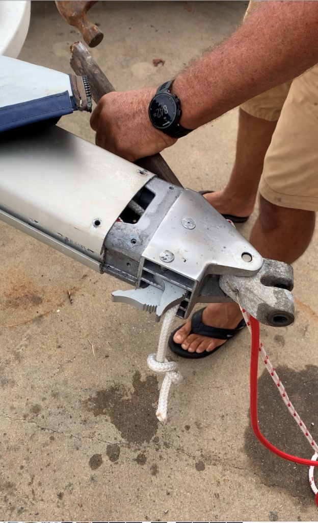

Removing the end of the boom using a wooden block and a hammer took very little time (surprisingly).
remove end.jpg (117.6 KiB) Viewed 5982 times

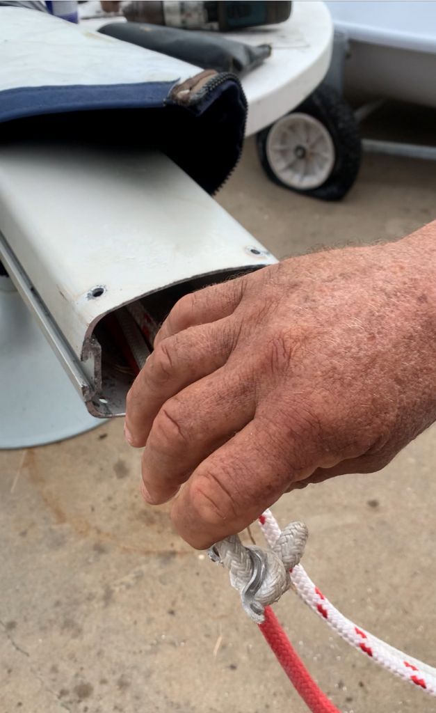

Pulling the end of the outhaul out of the boom was straight forward and the first thing to come out was the retainer ring. It was clear it had broken away from the boom.
After this it was a simple matter of re-riveting the retainer in place in the boom. Removing the pulley and untwisting the lines then attaching it to the new standing end retainer. Running a new standing end on the fwd pulley end (the aft end was in good condition and did not need to be replaced.). The pulley sheaves and its line were in very good shape (no UV inside a boom I guess.)
