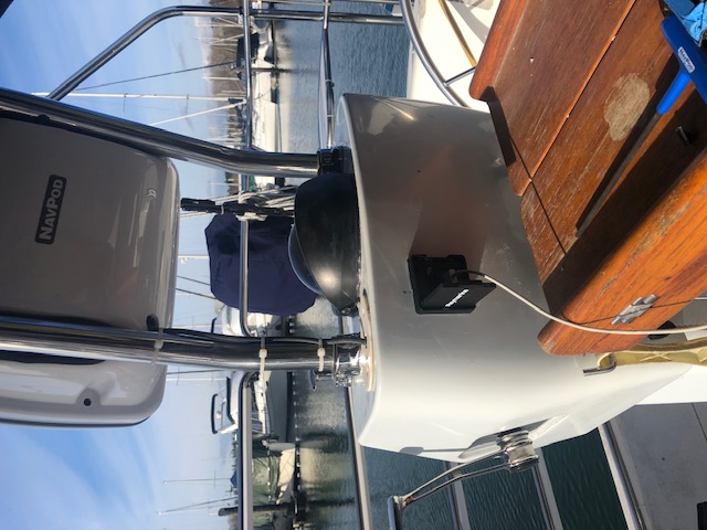

I installed one of those remote mSD carder readers.
It makes LH software updates easier. I download them to a mSD at home on the PC then use the card reader to install the software at the boat. I can update Navionic charts from the Navionic app on my iPhone.
But for updating the annual Navionic subscriptions - I have only done it once by opening the NavPod and taking the Navionics SD card out of the Axiom 9 and then home to download the new subscription by PC, take it back to the boat and reinsert it and button up the NavPod. It works but its a pain.
I don't know how to do subscription renewals by Wi-Fi, if in fact it can be done. But that would solve the problem.
The remote card reader is also used to store my user files, since RM does not recommend using the plotter card for this. I installed the remote reader on the forward side of the binnacle. It also has a USB plug which I use as a charging point for phones etc. I believe a USB stick can also be used as extra memory.

The only problem I had installing the card reader was trying to feed the cable into the binnacle tube, it was already mostly full. Also, the cable has a rather large connector so wouldn't fit and I didn't want cut the wire to feed it up the tube. So I ran it up the outside of the tube and into the back of the NavPod. You might be able to see that in the picture.
I have done the chart updates by syncing my Navionics app on my phone with the MFD Navionics. This is done by Wi-Fi between the phone and the Axiom. First I update the charts on the phone by WiFi or cell data and then sync with the plotter and all the charts get updated.
I have only done a LH update by downloading the update to a mSD card at home then putting the card into the remote reader, and doing the software update through the Axiom display. When you do the update just select the remote reader for the file location when it asks for the files.
I have the latest 3.13 update on a mSD card and I'm doing it this weekend when I go to the boat.
