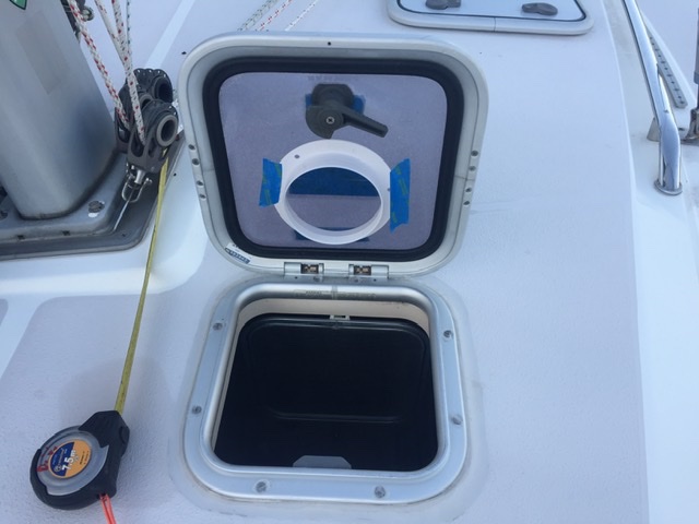

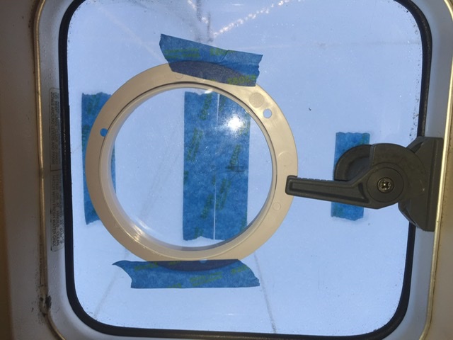

Any thoughts? I am about to drill a 4.75” hole in the lewmar hatch over the Head for a Marinco Day/night 4” solar vent. See photos below. The objective is to move air through the boat especially on summer days in the tropics buttoned up at the dock or while away exploring in a dinghy. I bought the biggest solar vent I could, the 4”. As Bill Cullen (Triumph) rightly points out you do not want to put this in the V-berth hatch due to waves and possibly water intrusion. The Marinco can be simply unscrewed from the outside, then someone can reach in and unlatch a main cabin hatch gaining access to the inside of your boat. Not good.
That leaves me with placing the 4” vent over the head. No one can fit through that hatch.
I can not center the solar vent in the hatch due to the locking handle underneath interfering with the vent. When I move the vent far enough back to clear the locking handle. The vent on top will hang over the rear of the hatch about a half inch. Really more an issue of being unsightly, and not necessarily an issue of impacting function of vent or opening of hatch.
My dilemma, do I buy a smaller 3” vent? Do I cut off a 1/2 inch of the locking handle? Do I install the 4” vent and always look at the lopsided installment? I want my cake and eat it too!

Photo from below showing locking handle issue

Please let us know what you decide to do as I am looking at doing this exact same project this winter. I am not near the bot, but when I looked at pictures I was concerned about the handle and you validated the issue. Without seeing it, I think I would go for the smaller vent.
Re: Solar vent in head Hatch?
Posted: Fri Dec 18, 2020 7:16 pm
by russp
Hi, mine is pretty much central, just means I can’t fully latch the cover but it has enough bite to be safe. I left handle the full size.

I was able to successfully install the Marinco 4” day/night solar vent in the Lewmar hatch over the head. $185 with tax from Defender.com The 4” moves 1,000 cubic feet of air an hour (24,000 cubic feet a day). Whereas the 3” solar fan moves about 1/5 less at 800 cubic feet an hour (19,200 cubic feet a day). Brand new out of the box with a 2 year warranty, they say it will run for 24 hours if fully charged with no more charging needed.
Pros and Cons of placing over the head:
Cons, 1) much darker in the head with the vent covering the majority of the hatch. 2) Could get fouled and damaged by a flogging jib sheet. 3) I had to cut 3/4 of an inch off of the Lewmar locking handle. Which does not seem to be much of a problem now.
Pros, 1) Even if unscrewed from deckside, boat can not be entered though the small head hatch. 2) Any leaks will drop on a fiberglass floor and not on fabric or wood if it was placed on main cabin hatches. 3) This has a built in night light that should work well in the head. In addition to my motion sensor light placed under the sink.
Below are two photos deckside. Note the vent is not exactly centered due to the locking handle below.
