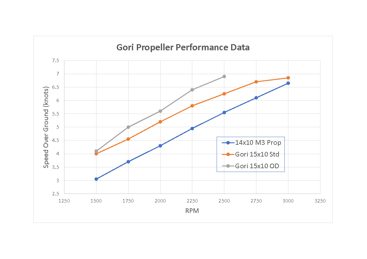

I do not have a Kiwi prop, but was also not satisfied with the standard 14x10 fixed blade prop. I believe you are correct in that it is vastly underpropped. We installed a Gori folding prop last winter and I feel it is the best addition I have made to the boat other than adding solar panels.
I am not sure that you could fit a 16.5" prop under a Catalina 350. The reason they switched from the 15x9 prop was due to cavitation issues related to the 15" prop being too close to the deadwood and bottom of the hull. Also I can't imagine a 21" pitch on that sized prop for this boat. Something seems drastically wrong there.
The unique thing about the Gori prop is that it is a 2-speed prop. You can shift from a standard pitch to an overdrive pitch via controlling the throttle. We opted for the 15x10 standard pitch with provides an 'overdrive' pitch of about 15x12. It's a little pricey at $2500, but I would never go back to a non-overdrive prop again. The overdrive feature gives you the option of changing the pitch based on the conditions you happen to be sailing (or cruising) in.
Below is a chart I created of our performance with the standard prop and the Gori 15x10 shortly after installation and new bottom paint. RPMs were measured with a optical tachometer on the crank shaft and SOG measured via the GPS averaged from 2 runs in opposite directions. Keep in mind our boat is generally loaded to the gills with cruising gear and is generally much heavier than our friends Catalina 350 Mark II that I previously could not keep up with. Recently we cruised together and I was able to catch up from an hour behind over a 30-mile sailing leg. We typically now run around 6 knots at 2100 RPM in overdrive. Occasionally switch to the standard pitch and run WOT for a short period to manage any carbon build up that may develop by constantly running at lower RPM. On the downside, our fuel consumption has increased from around 0.65 gal/hour to around 0.80 gal/hour. However, since we are going about 20% faster, our MPG are essentially the same (First Law of Thermodynamics - the energy in the fuel is converted into energy of the boat motion).

So after reading these various posts and particularly the excellent post from Gary and Janet "Best of Times" I decided to take the plunge (deep into my wallet that is) and go with the GORI prop. I was given the same recommended specs ie 15x10 prop. I also sprang for Propspeed after reviewing the topic in Practical Sailor and had it professionally applied ($250). The prop itself was airfreighted direct from Denmark and the cost was right at $2700.
The performance improvement while motoring is immediately apparent and roughly follows the data in Gary's post. With the standard 14x10 I struggled to make 6knts at 2500 rpm, now getting right at 7knts at same revs but in overdrive and about 6.7 knts in standard drive.
I have only sailed with the new prop once but my sense is that the boat has picked up perhaps a 1/2 knt or so and appears to be pointing a little better too.
All in all, this was an expensive upgrade, but so far I am impressed.
