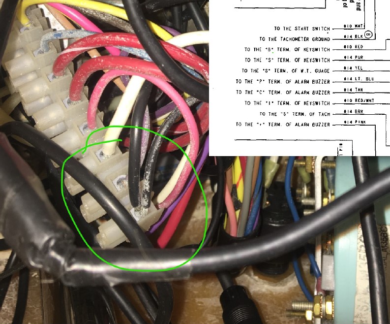

Two possible sources for your problem, either power to or ground from your panel. Easy things first. On the power side of equation, there is a breaker on the panel, small button on front of console, just double check that it hasn't tripped. It provides over-current protection/ power for the whole panel, although since your buzzer is working that solution is suspect, but worth a press. At some point you will have to check power to the panel to see if they are getting any. A volt meter would do that test. Attached pic of wire harness view down through compass, inset is color codes from pg 25 of operation manual. Check red and black with volt meter while battery switch is on. Should read 12v. If ok, turn on ignition switch then check red/white against black, should read 12v. But if you don't get 12 V on meter and since the engine starts from the panel / and buzzer works could be ground problem.
Ground problems could explain your symptoms. If the ground from the panel is compromised none of the gauges would work. The buzzer however, while getting power through the aforementioned breaker, is grounded via a different path, the switch on the engine (if oil pressure is too low, as when the engine isn't running, the switch is closed completing the circuit). I included a picture of the my 2006 panel wiring as seen down through the compass port. I highlighted the ground connection to the wire harness. Notice the corrosion on the black wires I found in my 2006. This is certainly a possibility, cleaning may help. If cleaning doesn't help you might have to track down where the black wire terminates and see if its disconnected or corroded.

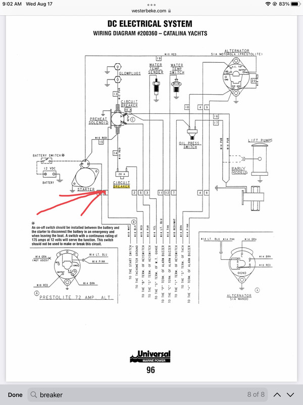

Good Morning fellow 350 Owners. My Ignition Key switch failed, and I replaced it, but have no power coming into the control panel. The excellent posts have helped me somewhat, in that I now (after 19 years of ownership) know that there is a breaker on the Control Panel, but I have no power coming into the connection strip behind the panel. The schematic shows there is a fuse or breaker somewhere in the red power wire coming in from the alternator. Has anyone found that? I looked all over. Any input would be appreciated. Thanks! Bob
Re: Engine Guages and Tach for M35B
I'm not near the boat now. But, if you are talking about the 20 amp breaker shown on the schematic, ours is located in the engine compartment. My recollection is that it is somewhere near the fuel lift pump. It is breaker with a red button that is labeled "20".
The circuit breaker that Gary referenced should be on the same bracket as the starter solenoid. I don't believe there's anything else around there with a red button. I'm not positive but I believe all C350's regardless of hull number have the Universal M35B engine. Here's the schematic from the manual -

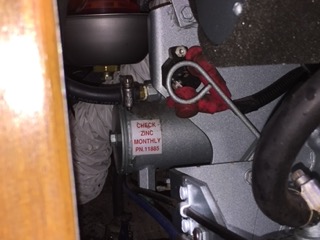

Just thought I would post some pictures on the location of this circuit breaker. It tripped on me last week the engine stalled as well. I couldn't restart the engine since there was no voltage to the instrument panel. The service manual remedy is "reset breaker, if opens again check preheat solenoid circuit and run circuit for shorts to ground".
