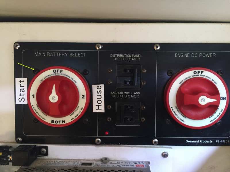

I'm finally able to update this project. There was no problem with the wire or any of the crimp connections starting from the bilge pump circuit breaker all the way to where the wire disappears into a bundle of several dozen others heading away from the electrical panel. I pulled the panel holding the distribution and windlass circuit breakers looking for the other end of the 14 ga red wire supplying the bilge pump circuit breaker. As mentioned previously, I was only able to tip the top edge of the panel out a few inches due to the limited slack and stiffness of all the heavy 2/0 size cables converging in the area. I only noticed two 14 ga red wires on the back of the panel. The one for the windlass foot switch was connected to the windlass circuit breaker. The one for the bilge pump was connected to a large stud on the back side of the OFF/2/BOTH/1 switch and shared with a piece of 2/0 ga cable (white arrow). The crimp ring connector looked fine so I cut and capped the wire at each end a ran a new one.
I'd love to know what/where the problem was but I'll settle for "pump is now working" and no power to the damaged wire.
