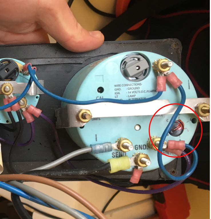

- scott.monroe
- Posts: 33
Re: Tachometer not reading correctly
Hello Richard,
Leigh Weiss mentioned this in 2014 but the rotary switch on the back could help the problem. See the picture.
I had had the same issue sometime ago and had contacted the manufacture/catalina(?) who suggested simply rotating the switch back and forth which helps clean up the surfaces internal to the tachometer. The important thing they said is to note original position of the switch so that it gets back to the correct operation. Have had good operation since.
Good luck,
Scott
Good luck,
Scott
