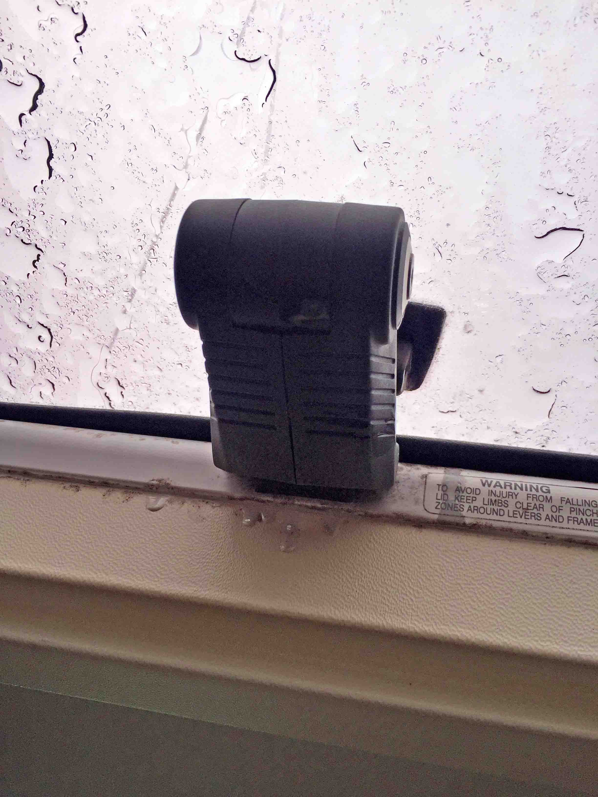

Leak From Hatch Hinge
Posted: Fri Jun 07, 2019 7:15 am
Yesterday during a light rain I noticed some water dripping from the hinge on the hatch over the dinette table. Because of the rain I was unable to open the hatch and re-torque the 2 hinge screws visible behind the pivot. Since it's a boat I'm pessimistically anticipating that something as simple as retightening 2 screws will fix a leak. Before tackling this issue are there any other gremlins that I need to be aware of?

Ken, I share your pessimism. I had a similar issue. Small leak at the hinge. When I opened the hatch I found the hinge was no longer attached to the frame, only to the lexan. Hatch hinges were always a bit stiff which is a good thing to keep them open. But I found the hatch attachment to the aluminum (I think) frame was done with pop rivets and had failed. The rivets are just like the ones sold at Home Depot. So much for “marine grade”. If this turns out to be what you find, have fun. I drilled out the old rivets and holes. Then installed stainless screws through the frame into the fiberglass. Much stronger now.

We have a Lewmar 40 low profile hatch on our 350.
Other leak points could be any of the following:
- the rubber seal around the lense
- the butyl seal between the hatch frame and the deck
- the screws thru the lense that attach the friction arm to the hatch cover.
By selectively pouring water over the various leak pts, working from low to high, we found the lense seal to have failed. The port hatch failed first and the starboard hatch failed a couple years later.

Thanks Rick & Alan for your pointers. That gives me plenty to check out when I tackle this project. I'm hoping it's not the buty seal since I re-bedded this hatch last year.
