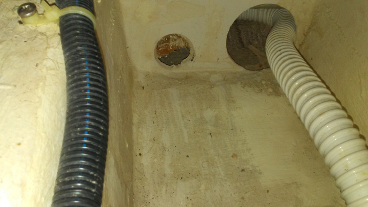

Posted: Wed Aug 23, 2017 7:17 am
Ralph,
I had some time to check out the boat yesterday and found the 'tunnels' just as you described them. They are more obvious when looking at the bilge area under the head sink, which looks to be a good location for the secondary bilge pump.
Head Bilge.jpg (89.24 KiB) Viewed 18707 times

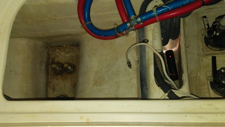

You might also note that this research resulted in my discovering why our mast mounted TV antenna no longer worked!
I placed a flashlight in the 'tunnel' to confirm where it went going aft, and low and behold it was where the primary bilge pump discharge hose ran.
Bilge Pump discharge.jpg (82.84 KiB) Viewed 18707 times
Apparently it runs without obstruction to the vast open area at the transom where you can see the primary bilge pump discharge and the suction line for the manual bilge pump run. Hopefully there is sufficient space left for a third hose.
What are your thoughts regarding splicing into the existing thru hull discharge versus installing a new thru hull on the port side? I'm leaning toward splicing into the existing discharge rather than put another hole in the boat. It appears to be 1-1/2" all the way. The manual pump has 1-1/2" suction and discharge, and the primary pump has a 1" discharge that is teed into the manual discharge line just ahead of the thru hull.
What are your thoughts regarding redundant power source? Splice into the power to the primary pump or run a new line direct to the batteries? I'm leaning toward a new completely redundant power source straight to the batteries. Fused of course, but not switched other than a float switch. I don't understand why one would put a switch on the panel that allows you to accidentally turn off the bilge pump. I would think the bilge pump would be one thing that should have as few components as possible that could become a point of failure.
Thanks for your input

After looking at Gary's pictures I did some further exploring on the boat. It appears some changes were made on my model year (2008 MkII). The hose from the electric and manual pump come under the cabin floor from the main bilge but then run alongside the fuel tank through a tube and exit to the stern. I don't have that nice open space seen in the picture above. Going to have to keep looking but as with most jobs on the boat I don't think this is going to be an easy fix.
John
