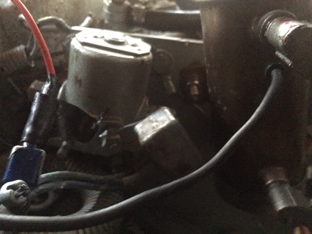

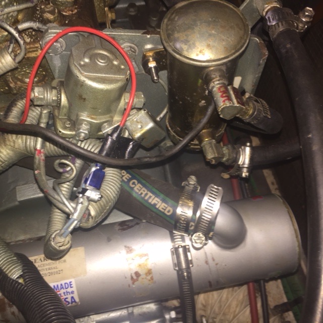

Thanks for all your replies and messages. Had the Admiral turn the key while I listened and I heard nothing. So, I am going to try NAPA for a pump and if they don't have one I am going to order one online from Aircraft Supply.
I am also going to try to figure out how to electrify the fuel lift pump without turning they key since I am frequently on the boat myself. (I used to have a 1982 Catalina 27 with an 11hp diesel that I bought new that I could bleed the fuel from down below. That was pretty useful.)
I forgot to post the picture so I am trying again.

I had a similar problem with the break in the wire under the electrical tape last summer when motoring into Pelican Bay. The motor stopped until I reconnected the wires. I am slowly going around an fixing the twisted and taped connections. I am also trying to get the wiring size and color back to the specifications.
Re: Not running due to fuel
Posted: Wed Mar 22, 2017 7:08 pm
by JohnForr
Thanks for all your help. The hopefully final outcome. I had a bad wire leading to the fuel lift pump. The wire looked fine, but somehow it must have been broken under the insulation. Someone had spliced in a red wire for some reason. After cutting out That wire and putting on a new connector I got a strong chatter sound from the pump. We had to bleed the air out even though it is supposed to be self priming.
