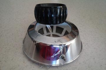

Posted: Fri Dec 30, 2016 9:19 am
I took one down that was damaged and moved a good one from the "aft garage" to the cabin that I am using to try to figure out how to get them apart. I was successful in getting the black ball-like insert to pop out of the housing (see photo).
Ceiling Fixture.jpg (13.46 KiB) Viewed 16395 times
What I am still unclear about is whether the black ball 'unscrews' as Russ noted, or whether it 'pops apart'. I can't see how it could either unscrew or pop apart without removing the entire fixture from the ceiling.

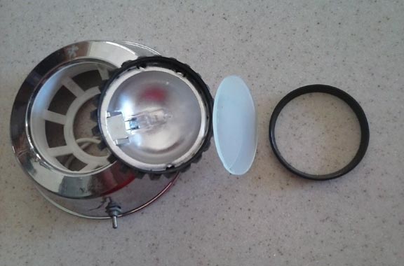

Posted: Fri Dec 30, 2016 9:40 am
OK, I finally got it apart. The trick is the small bezel on the black ball pops off. Now that I know how it comes apart, you could remove the bezel while the fixture is still in place. Here is a disassembled view for all of posterity:
Ceiling Fixture 2.jpg (30.8 KiB) Viewed 16393 times
Re: Replacing Cabin Ceiling Light Fixture
Posted: Thu Jan 12, 2017 8:49 am
by JohnForr
Thank you all for the comments and suggestions. I know this is a rehash of what others have said. I was able to pop the bezel off with the fixture in place and place LEDs in. I shined a strong light on the black moving part of the fixture and I could see a slight crease and I put a fingernail in and held top portion and rotated bottom. Popped right apart. I did drop a few lenses and none of them broke.
