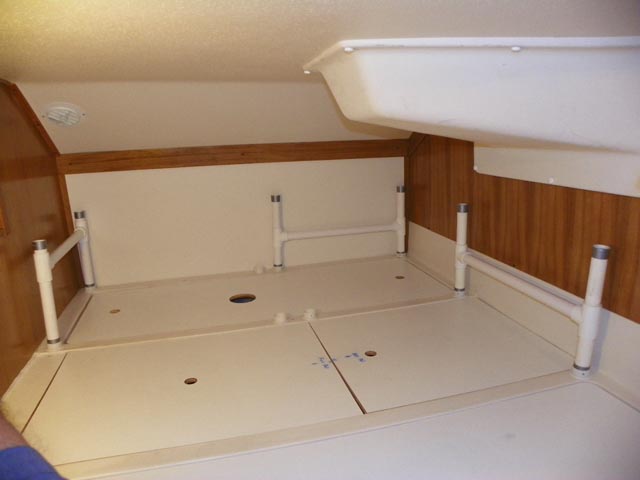

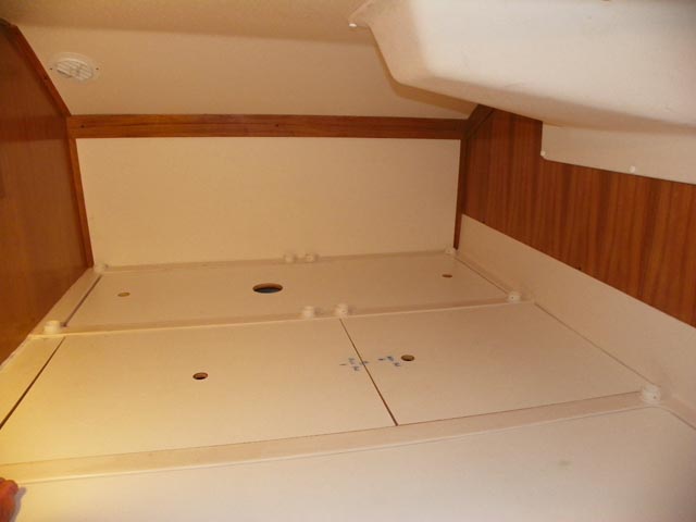

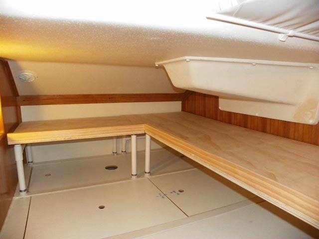

We just returned from an 11-day cruise with the new modified aft garage. It was great to be able to keep all the 'toys' a little more organized.
Here are some photos of the nearly finished project. Some time, I plan to take the shelving out and paint it so that it will be more resistant to absorbing moisture.
- Just one threaded hole at the base of each leg support.
- Typical Leg Attachment.JPG (14.52 KiB) Viewed 23688 times
- 11 closet rod supports for the shelf leg positions.
- Boat Modifications.JPG (20.99 KiB) Viewed 23688 times
- Shelf legs were paired to create H-Frame supports as much as possible. Central legs were left as single posts to allow ease of removal if necessary to load or unload supplies.
- Shelf Supports 1.JPG (24.61 KiB) Viewed 23688 times
- The 1" PVC pipe used for the legs was a little loose in the closet rod supports, so I added 5-turns of duct tape on each end of the legs and 2 set screws at the bottom of each leg to keep the supports rigid.
- Shelf Supports 2.JPG (32.79 KiB) Viewed 23688 times
- Aft Shelf Install.JPG (30.23 KiB) Viewed 23688 times
- Ready to Load 1.JPG (31.42 KiB) Viewed 23688 times
- Ready to Load 2.JPG (29.33 KiB) Viewed 23688 times
- Finally, I can access the 'tunnel' and seacocks from a fully loaded aft garage.
- Ready to Go.jpg (42.98 KiB) Viewed 23688 times
