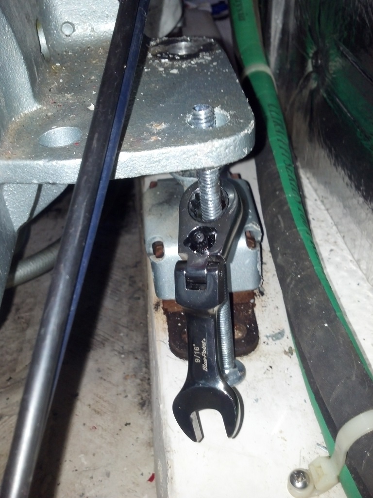

I just finished installing the damper place. A couple of notes.
PYI changed the part number from a 22AA4 to a 22AM4. Three months ago when I bought it, it was $225.00.
I found using a reversible stubby flex head ratchet handy for running those nuts up. I never owned stubby wrenches before, but they were useful on this job. It was great for the cramped space.
- Damper Plate Stubby Flex Head.jpg (216.45 KiB) Viewed 450609 times

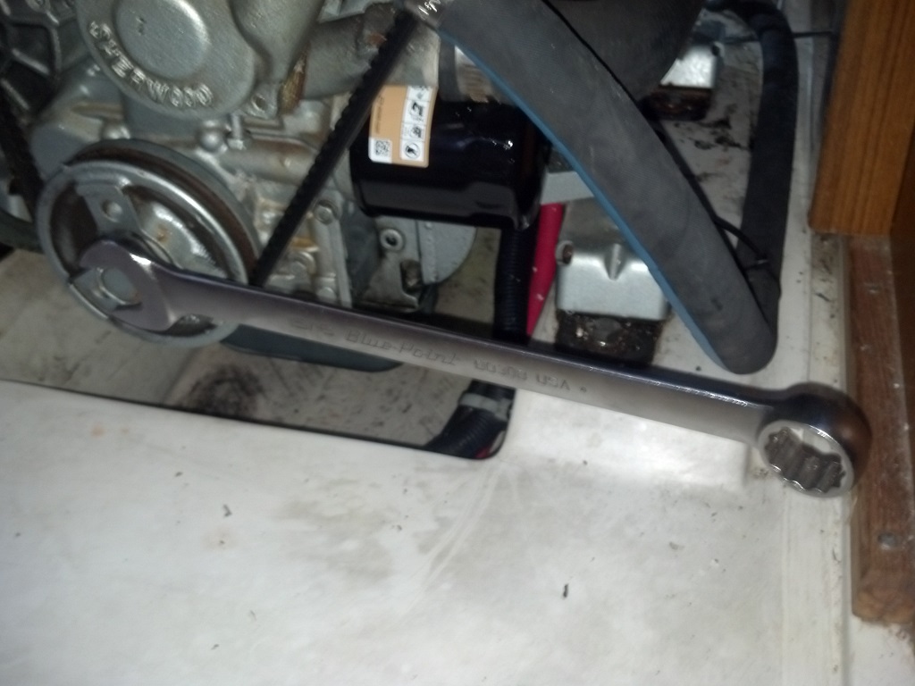

Also, no reason to try and bump the engine with the starter, you can bar it over with a 15/16" wrench.
- Damper Plate Barring Engine.jpg (157.43 KiB) Viewed 450609 times
I wasn't real keen on the carriage bolts. They kept moving around. Maybe a regular bolt with a hex head and piece of rubber underneath? I also used a prybar on the motor mount to push the feet back so the engine would drop over the stud when reassembling. That made it easier.
Thanks for all the info. I would not have had a clue otherwise. Thanks!!!
