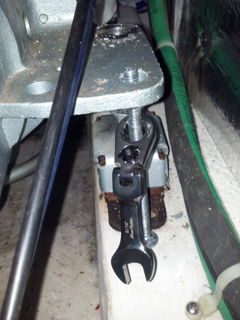

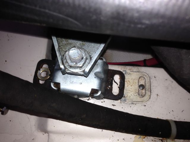

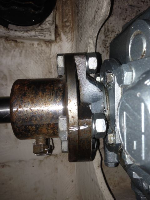

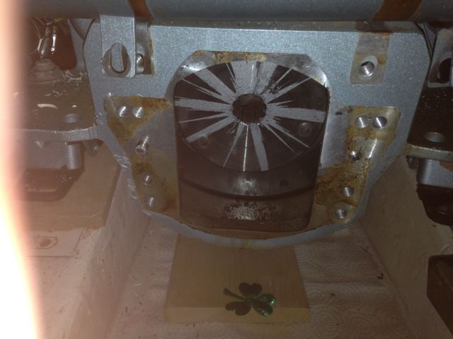

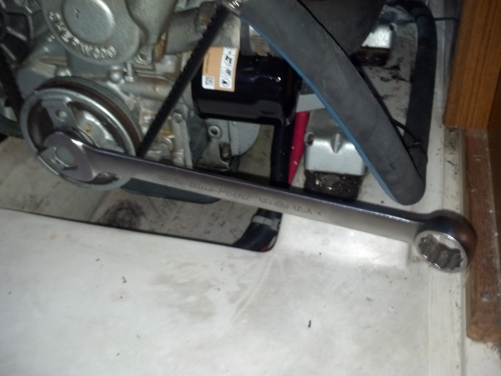

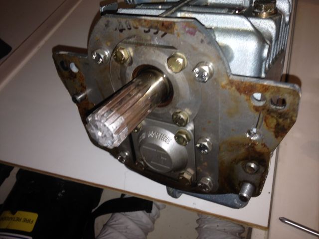

I just finished installing the damper place. A couple of notes.
PYI changed the part number from a 22AA4 to a 22AM4. Three months ago when I bought it, it was $225.00.
I found using a reversible stubby flex head ratchet handy for running those nuts up. I never owned stubby wrenches before, but they were useful on this job. It was great for the cramped space. Also, no reason to try and bump the engine with the starter, you can bar it over with a 15/16" wrench.
I wasn't real keen on the carriage bolts. They kept moving around. Maybe a regular bolt with a hex head and piece of rubber underneath? I also used a prybar on the motor mount to push the feet back so the engine would drop over the stud when reassembling. That made it easier.
Thanks for all the info. I would not have had a clue otherwise. Thanks!!!
(wow. those are big pictures. I'll remember to make them smaller next time.)

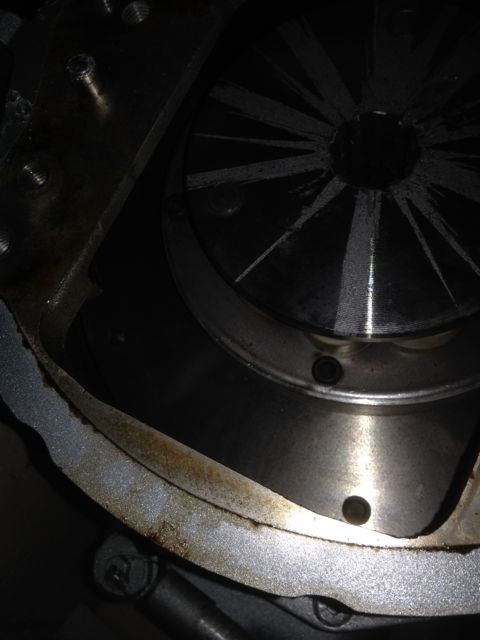

Thanks for the excellent write up. I'm fairly sure I have a similar problem as I've located some brown granules in the bilge. I also have a bit of black pepper looking stuff mixed in with a few drops of oil.
We have been in rough seas over the past month and we've pushed S/V Soixante hard but also idled in some difficult sea ways. We also have logged about 200 hours between trying to get to the Abaco Islands and Racing in St. Augustine.
I did call ZF and they confirmed that not replacing the damper plate would result in not being able to shift into gear.
Fortunately, I'm just at the beginning of this problem but it's a must fix before our next long journey.

Re: Damper Replacement
Yup: it's the damper plate. Mechanic just left and I'm ordering the parts.
I had also had overfilled the transfluid and we changed that out and corrected the level while he was here.
I'm going with the PYI damper plate upgraded version RD 22AM4.

Things I learned while replacing Damper Plate
Our engine sounded particularly rough this season so Damper Plate replacement seemed in order. It was 10 years old. Had ordered PYI damper plate RD22-A-4 two years ago just in case. Took 5 hours to do. No need to remove the heat exchanger, I started to and it was hard to get the bolts back in as the brackets are spring loaded.
I did not have the proper socket to loosen the nuts on the top of the motor mounts (larger than 7/8 inches), so in the end I removed the transmission shift cable, and removed 8 of the engine mount bolts at the base and just pulled the engine forward a few inches. I did not have to remove the throttle cable. I used a 2 by 4 to lift the engine, it was not as heavy as I was expecting. I am guessing it weighs around 300 pounds. I just put some scrap wood under the rear engine mounts to hold it up a bit. Also I was not able to remove the adapter from the prop shaft and slide it backwards, so pulling the engine forward would saves the hassle of loosening this. As mentioned previously the port bottom bolt on the transmission must be removed last, and the bolt above it second last. These nuts are very strange as you can't get a wrench on the bottom bolt if the one above it is loose. I used a large wrench to rotate the engine in order to get at the damper plate nuts (two are visible at a time). To do this job some bolts seem to be metric, and others inches, most of the bolts were 17 mm on the transmission. Photos are attached below.
The engine is so quiet now, its great.
Jan #303
Jan #303
- Engine mount removed and slid forwards
- IMG_0961.jpg (39.75 KiB) Viewed 448750 times
- Transmission removed
- IMG_0960.jpg (45.43 KiB) Viewed 448750 times
- IMG_0959.jpg (41.6 KiB) Viewed 448750 times
- Tranmssion/Prop coupling
- IMG_0958.jpg (53.49 KiB) Viewed 448750 times
- IMG_0964.jpg (36.51 KiB) Viewed 448750 times
