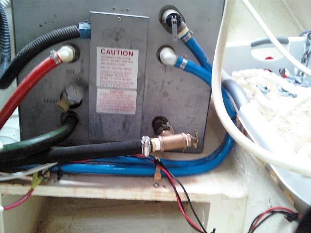

Boy, when a lot of folks have the same problem, one wonders about design issues???
Anyway, I did find the very small leak at the water heater (my former boss would scream if I said "Hot water heater", since it is redundant- but I digress)
It is coming from the tee fitting with the bleed valve. Does anyone know the part number for this gem? It looks like a different kind of polymer (clearish).
thanks
thanks

I had the same problem about five years ago. The problem is the plastic T assembly. I went to a marine hardware place and purchased bronze fittings and made a new comparable assembly. Very easy to do and have had no troubles since.

thanks. After I posted my message, I thought about making a replacement one out of bronze!

I forgot to ask. Do you remember the hose size that is connected to the tee? I know it was smaller than the 3/4" elsewhere on the boat.

I don't recall the size. I remember taking the plastic assembly to the hardware store and comparing parts.

I found two sources where coolant was leaking. One is the clear plastic hose that leads to the plastic expansion tank which i replaced with heater hose, and the other is the fitting at the water heater. As I recall I did climb down through the port side after removing the shelf and reached around the steering quadrant to do the replacement. When the fitting is removed you want a container to catch the coolant that will now leak out of the water heater. As I recall the amount that comes out is nominal since the water heater is at the top of the system. It is just the volume inside the coils in the heater. I do recall opening the bleed valve at the heater upon startup to make sure air was purged from the system and had to add some coolant in the expansion tank to replace what had drained out. Not a big job.

I am pretty skinny and am able to get into the aft transom locker (still a tight fit). I did see red coolant stains around the tee and at the exit (?) hose from the heater. But I think the leaking fluid simply ran down the T-leak hose and dripped at the low point onto the wood support shelf. I am going to replace it this weekend and will let folks know how I did and then provide a parts list on what I needed to replace.

I am attempting to attach a few photos of the bronze part and installation
- hot water 4.jpg (59.9 KiB) Viewed 23597 times
- hot water 3.jpg (59.14 KiB) Viewed 23597 times
Bill VanWagoner
