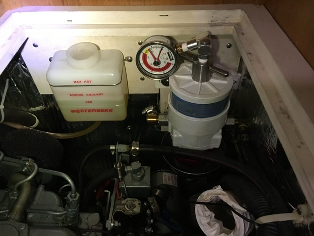

This thread goes back a while and ended with comments about installing the Racor vacuum gauge. For those who have installed the gauge, where did you find the headroom to install the Racor filter and gauge since the gauge adds almost 3” to the top of the filter housing?
In my boat, the Racor is installed behind the M35B in the starboard aft corner of the engine room wall under the horizontal access panel of the aft berth. If I move the mounting down far enough for the gauge to clear the cover, the bottom of the bowl is resting on the heat exchanger. Can’t imagine the engine vibration won’t destroy the filter in short order. I looked at moving the filter around the corner on the aft wall, but there is no better clearance to the heat exchanger.
My last resort might be to cut a notch out of the cover to give an extra 1/2” or so clearance between the filter bottom and heat exchanger.
Any other better ideas?

I stumbled upon a solution when looking at the possibility of using a short pigtail of compressor hose and found a rotating fitting. Installed, it only pushes the cover up a quarter of an inch.
