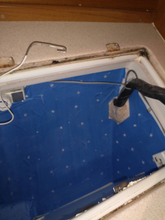

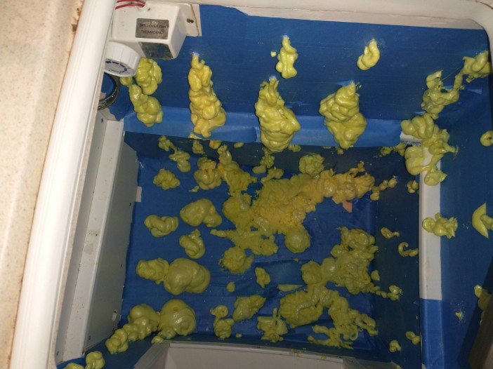

Foaming from the inside is pretty easy. Use the minimally expanding door and window foam and seal the holes with epoxy or 5100. Note: the first pic below is the finished job.
- IMG_20230617_103041557_copy_1152x864.jpg (126.77 KiB) Viewed 23936 times
- IMG_20230616_182724076_copy_1728x2304_copy_570x760.jpg (63.46 KiB) Viewed 23936 times
- IMG_20230616_201425622-2_copy_4258x3193_copy_2129x1596_copy_702x526.jpg (81.97 KiB) Viewed 23936 times
Re: Spray Foam Access
Great idea taping the liner before injecting foam. The last pic shows why ! Also wear disposable gloves. The foam is nasty and difficult to get off unprotected skin.
If you go this route, be very careful when moving the evaporator. There is copper tubing hiding under the black foam insulation and can be kinked if you're not careful.
