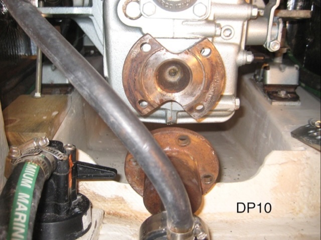

Re: Engine/motor mount replacement
"With the couplers aligned and bolted together, use the feeler gauge to measure around where the two faces meet. That gap should be .003" all the way around."
Is this correct? I thought the couplers weren't bolted when checking the gap? How is there a gap when bolted together?
Ed
Hi Ed,
So, if I remember correctly, the transmission coupler is not perfectly flat.
Take a look at the photo below. You'll see that there is a "raise" on the inner surface of the coupler.
That is what provides the "gap" when the two couplers are bolted together.
I may not be articulating this clearly. Maybe Brett, or someone who has done one of these can better explain.
