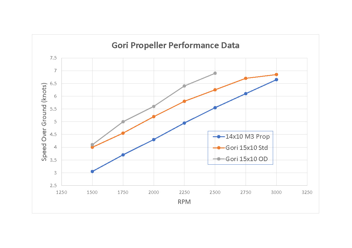

Re: Prop replacement
I finally had some time to gather performance data for the Gori 15x10 folding prop that we installed on The Best of Times. I am very pleased with the performance of the Gori prop. Essentially, our speed over ground increased a 1 to 1.5 knots at 2250 RPM versus the original 14x10 M3 prop.
Prior to replacing the prop, I gathered actual data for the factory 14x10 M3 prop. Then gathered data for the new Gori prop in both 'standard' pitch and again in the Gori 'overdrive' mode. Data was collected at a range of RPM with runs both with the wind and against the wind. The upwind and downwind values were averaged.
Both the Gori 15x10 in 'standard' and the factory 14x10 were able to reach 3,000 RPM, although both began to run a little hotter (175 versus 165). No black smoke was observed. Our WOT out of gear RMP is around 3200. The Gori in 'overdrive' maxed out RPM just over 2500 RPM. Still no black smoke was observed.
Now to gather data on what fuel consumption is now. Previously we had to run around 2750 RPM in order to average 6 knots. The Gori averages 6 knots around 2350 RPM in 'standard' mode, and 2125 in 'overdrive'.
Here is a chart of SOG versus RPM for all 3 scenarios:
Gori Performance Chart.JPG (116.24 KiB) Viewed 97468 times
