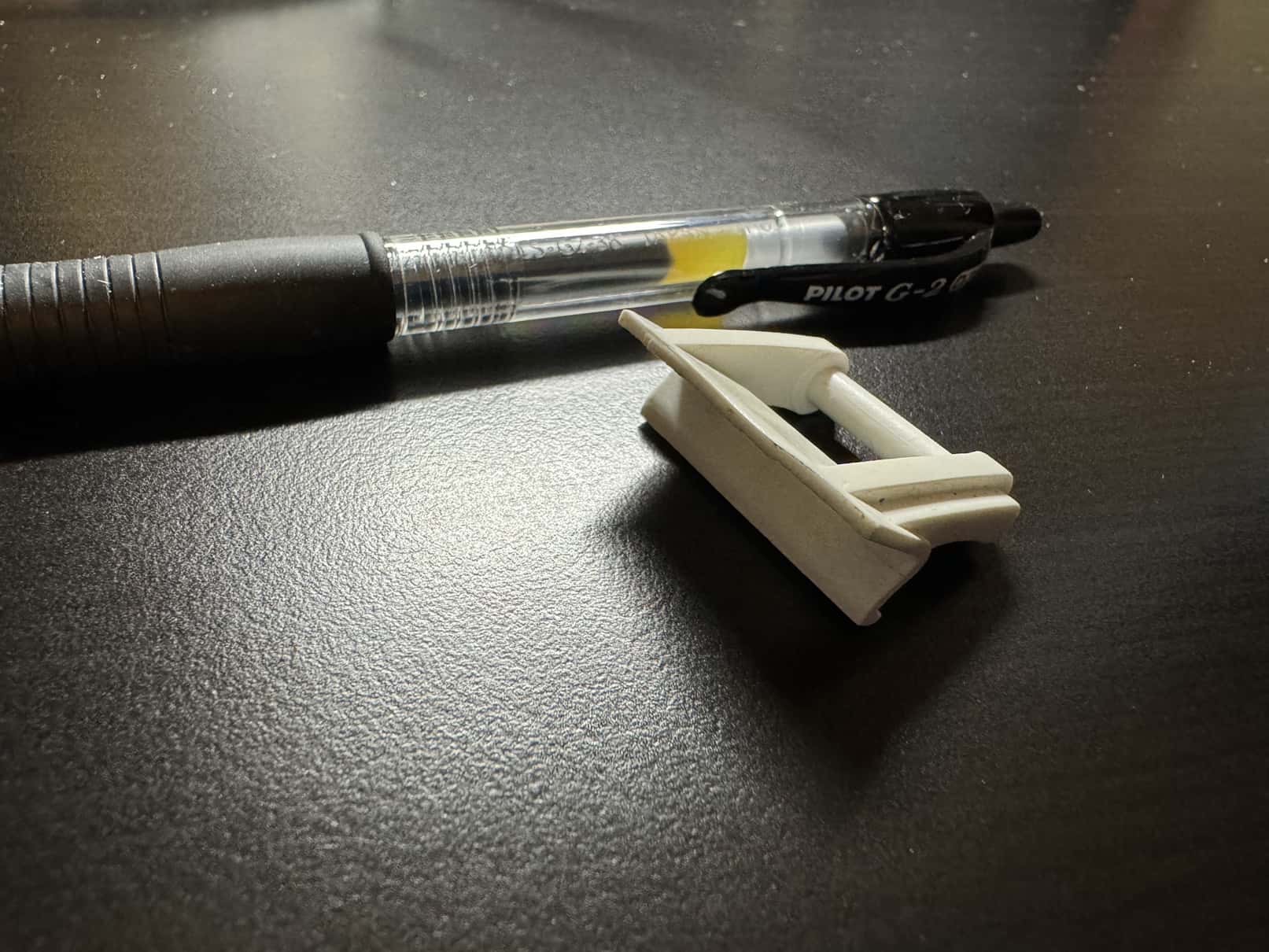

We are trying to locate the part of the hinge screen that attaches to the screen (not the bracket on the framing). Mine cracked and broke on both sides of hatch above forward berth. wrote to CatalinaDirect and they do not have that Harken part anymore (it’s been out of production for some time). They recommended to contact other Harken dealers or purchase from them the newer screens that use different frame and hinge/attachment)..
Can anyone suggest Harken dealers or another place where I can locate plastic part? I’ll try to attach pix..
Any assistance or suggestions are appreciated!
Clip
Clip
Broken clip
Broken clip

Hi Ave.
I believe the hatches are Lewmar not Harken. You might try to contact them.

Defender has a solution.
Lewmar Retrofit Flyscreen Hinge Kit - 361196992

Thx All! I ordered the kit from Defender. Will update if it is correct fit. Thx again
