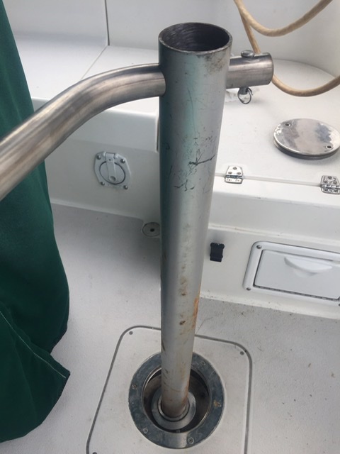

Emergency Tiller:
The Catalina Owners Manual (pg. 58) has very minimal instructions about how to use the Emergency Tiller (ET). They do suggest doing a dry run and those (Capt. and crew) who normally sail the boat know how it works.
Locate the emergency tiller. Probably in a red canvas bag in the bottom of the lazaret.
Remove the wheel, this also takes the steering lock off. Keeping a wrench handy for this purpose.
Remove the 6” cover over the rudder post, behind the wheel. Takes a special tool. I tie mine to the ET shaft.
Insert the shaft (large pipe) with the two slots cut in it. Over the 3/8” bolt at the top of the rudder post.
Remove the split ring and the clevis pin from the actually emergency tiller that comes in the red bag.
Stick the short bent end of the emergency tiller from the bow towards the stern, through the two holes in the ET shaft.
Replace the clevis pin and the split ring into the emergency tiller.
Note: The emergency steering tiller moves the whole steering, including cables and quadrant.
These elements must be free to move, in order to steer the boat.
The 6” plate has an “O-ring” and is threaded. Periodically check that the plate is freely removable. The “O-ring” is in good condition and that the compartment below it is dry. Water has a habit of collecting in it. I used a stiff brass wire brush to clean the threads both on the plate and on the base attached to the deck. Re lube the “O-ring”. Beware when working inside the compartment, because the 6 screws securing the base down extend below the deck and are very sharp.
After looking at my emergency tiller, I decided to clean up the steel post and paint it with rust-oleum.
Photos to follow......
