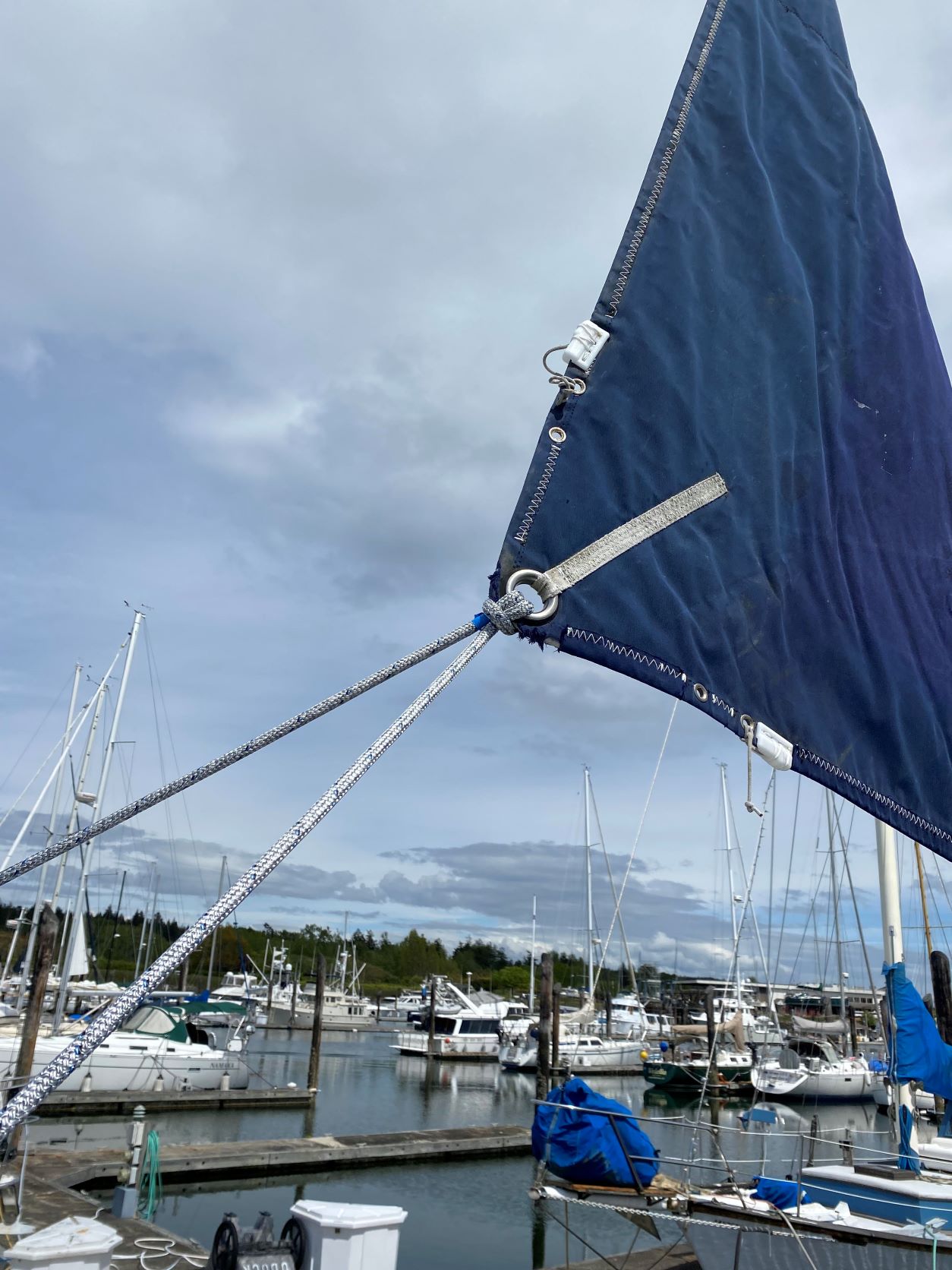

I just have a pic of the clew on our 150% genoa. You can see the cow hitch used in place of the 2 bowlines. Hope this helps.

I need to replace mine too. What's the width of your new sheets??

I used 12mm Marlow Yachtbraid. Its a little bigger than 7/16", so very close to 1/2".
