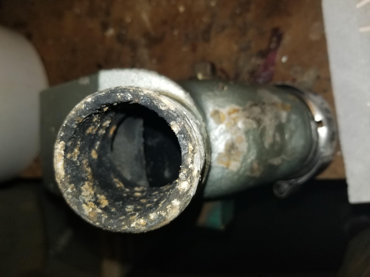

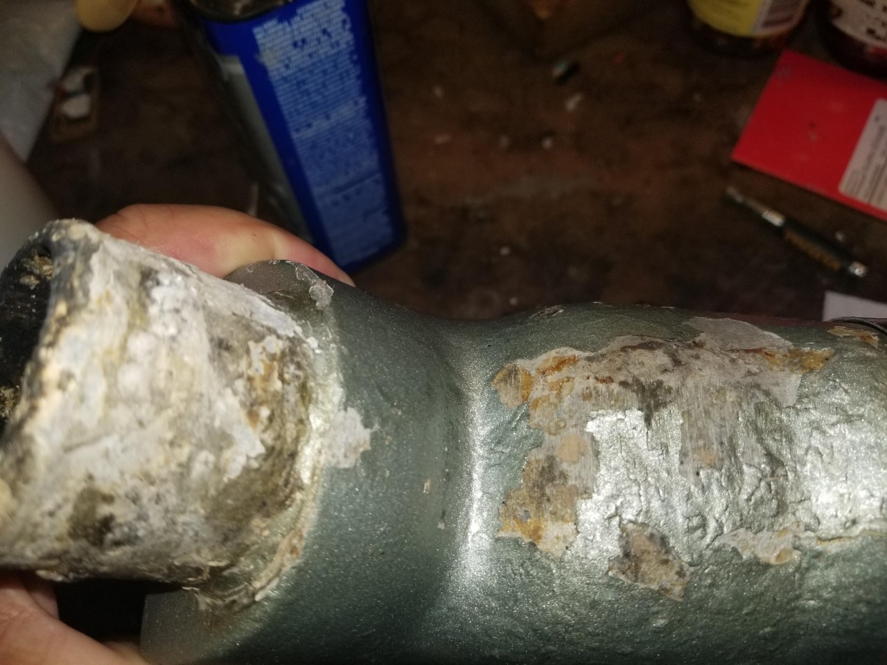

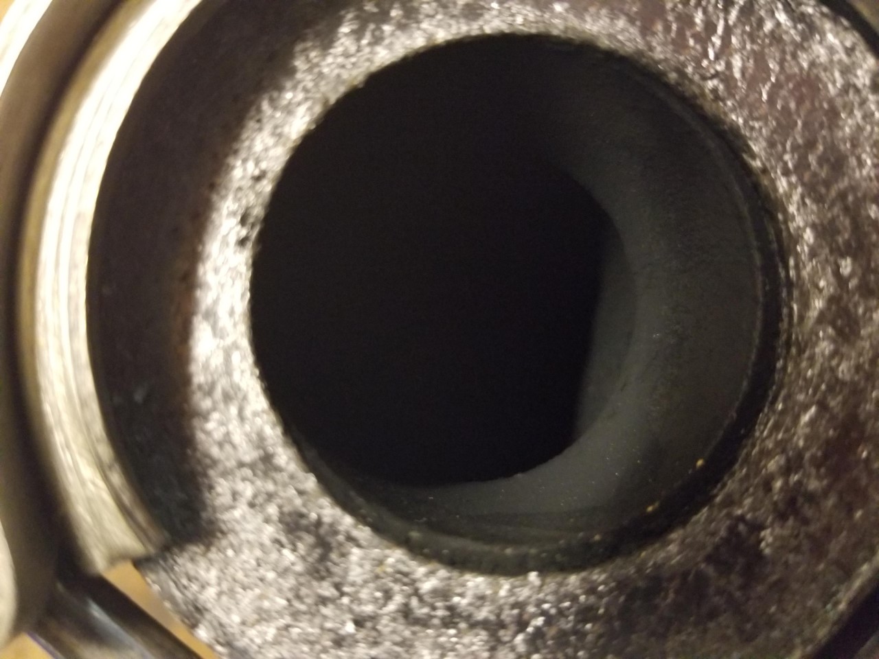

Here are the pictures that I don't think got attached.
Jamie
Sail #444
S/V Soixante
Jamie
Sail #444
S/V Soixante
- exhaustmanifoldbowl.pdf.jpg (239.96 KiB) Viewed 37933 times
- riser-manifold exhaust side
- exhaust riser, manifold side.jpg (193.36 KiB) Viewed 37933 times
- riser bowl view
- manifold/exhaust side
- exhaustmanifoldexhaustside.jpg (155.73 KiB) Viewed 37933 times
- part number 200490 (kit)
- 200490-200x200.jpg (7.84 KiB) Viewed 37933 times
- Posts: 167
Re: I need a new engine!! ugh
Hi Jamie,
I replaced my riser this past week.
Your pictures closely depict the condition of my riser inside and out.
My boat is a 2004 with 1,600 hours and the riser had never been replaced (salt water environment).
I was expecting the interior to be pretty clogged up, but it wasn't...just some pitting.
I spoke to a guy on the dock that has a trawler with twin Cummins turbo diesels. He takes his risers off and has them "boiled out" and puts them back on. The risers for our 350's are cheap enough to just replace them.
The replacement was pretty easy, but you'll need a torque wrench to properly tighten the bracket that connects the riser to the manifold. A one page instruction sheet is included in the kit.

Looking at those pictures (outside of exhaust elbow), I suspect you have a lot of corrosion in the engine room.jrohrbaugh wrote: Mon Sep 14, 2020 1:40 pm Here are the pictures that I don't think got attached.
Jamie
Sail #444
S/V Soixante
If you store where you have shore power, I STRONGLY recommend a 30 pint home dehumidifier set at 50%. Leave engine access hatches open for air circulation.
We put ours on a piece of plywood, cushioned with a towel so it doesn't scratch the galley counter. Condensate drains right into the sink and overboard.
