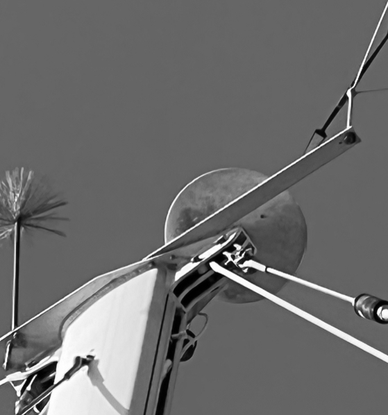

I was hoisted up the mast of my 2005 C350 in order to perform an inspection and repair the windex. The top of the GPS antenna was found completely missing with the electronics exposed and rusted. I did notice a single coaxial connection. I’ll respectfully request information on the original 2005 C350 GPS Antenna part number and suitable form, fit, function replacements if that original part is now obsolete.

When I originally identified the mast top antenna cover missing, I thought it may have been GPS antenna - but now believe it’s a Triax UFO antenna supporting UHF/VHF/FM TV signals. Triax UFO antenna (part number 109680) was likely analog in 2005.
Once I confirm my guess (feedback appreciated), I’ll need to plan steps to remove the antenna and attach a sealed cover plate to prevent water intrusion into the top of the mast.

Photo attached:

That definitely looks like a TV antenna to me.
Re: 2005 C350 GPS Antenna Replacement
Agreed. Most likely a TV Antenna. It looks like the one we have on our boat (2007). Ours no longer works or there is a bad connection somewhere. We purchased an antenna from WalMart that we just lay on the cabin top near the traveler and get acceptable reception in most areas.
Yup, your picture confirms it is the TV antenna.
