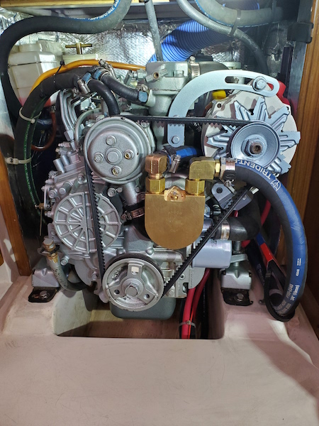

I chose the Ancor raw water pump made in Italy. Id have to look but about 600 CAD.
The existing 90 degree barbed fittings will not screw into the body without the riser nipples as shown.
This I did not like this as every fitting joint is another one to seal.
Interestingly the Sherwood pump impeller cover will fasten right to this. I may restore it and install it so as not to use the risers.
Impeller size is identical, seals etc are all identical.
It is working well but there is a very difficult little leak I am trying to chase. At, most likely, the riser joint.
When I take this apart this winter to inspect the impeller and fix this leak I am going to re route the pressure side hose out board beside the intake hose and out from against the engine and away from the back / bottom of the alternator. Will require a new longer hose but much better.

hperros
- Posts: 56
Re: M35B Coolant Water Pump
How do you keep your engine so clean? I am jealous! Any pointers???

- Posts: 72
Thank-you!
It was not like this when we bought her but some Spray 9, rags (way better than paper towel), Q Tips, eccentric fussy detailing gene, time and
a perfectly aligned belt really helps.
