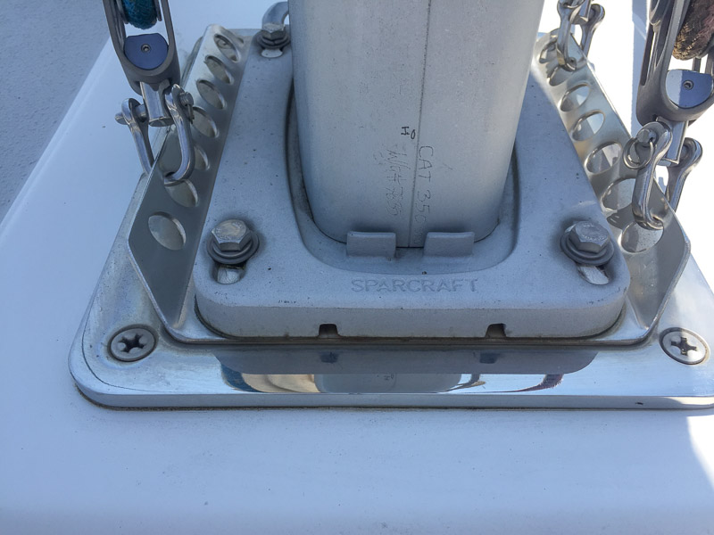

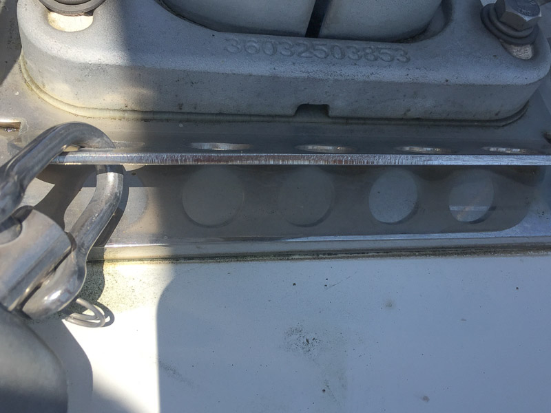

- Posts: 673
Re: Mast and water in bilge
Bill I don't have a furling main but I suspect our mast steps are the same. I was washing my boat down yesterday and your post came to mind. I directed a the stream of water into the drain hole and all sorts of debris came out. Some of it was good old Georgia red clay and I suspect mud daubers have a nest inside. Note the the front part of the step has 2 drain holes and the aft has 1.
- Posts: 149
Hi Ken,
I really appreciate the photos!!
I live in Cumming, GA, but my boat is in Charleston, SC. I hope to be back in a couple of weeks...
I don't think I have those drain holes in my step, but I may have just been focused on the mast itself.
I'll let you know what I find.
Thanks again,
Atlanta, GA

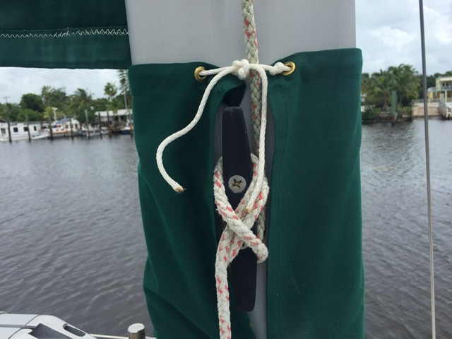

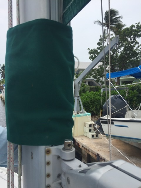

- Posts: 41
- Joined: Sun Aug 09, 2020 12:20 pm
Greetings all:
As a new owner, am slowly going through the old post. This post caught my attention. Yes I have the three holes in the base of the mast step just above the deck level. Ken talks about possible mud daubers. We used to live near a restaurant and people would feed small bread rolls to the local squirrels. Who would deposit them in our sails for the next winter in south Florida.
I had the great fortune of having a fellow C350 owner, Bill Cullen, help me sail my boat home. We discussed the open area of the main sail roller furler. Specifically, how the sun was eating up the exposed sail foot at each wrap. Bill said we need to have a removable canvas sleeve around the mast. My wife was kind enough to sew one up. Not only does it keep the sun off of that part of the sail. It would also keep out rain, squirrels and maybe a mud dauber or two.

- Posts: 14
- Joined: Sat Jan 07, 2017 3:00 pm
I too have the rain leak problem at the mast and I am going to try the canvas sleeve. Just wondering if anyone has had to remove the mast and reseal the wiring conduit, assuming this is possible. I brushed and flushed out the holes but this did not solve the problem.

- Posts: 41
Lagniappe:
Don’t be confused with my mast sleeve, it is really designed to keep the sun off of the exposed sail inside the mast. I do suppose that if it was bigger and had more wrap to it, it would keep the majority of water out. I just cleaned the boat yesterday after sailing for the weekend. I did a quick squirt of water at the weep holes.
Instead of trying to flush the weep holes with water. Have you tried an air hose. Using air you could tell if water comes out afterwards. Versus using water and not being able to tell the difference between what you sprayed on and what might come out.
