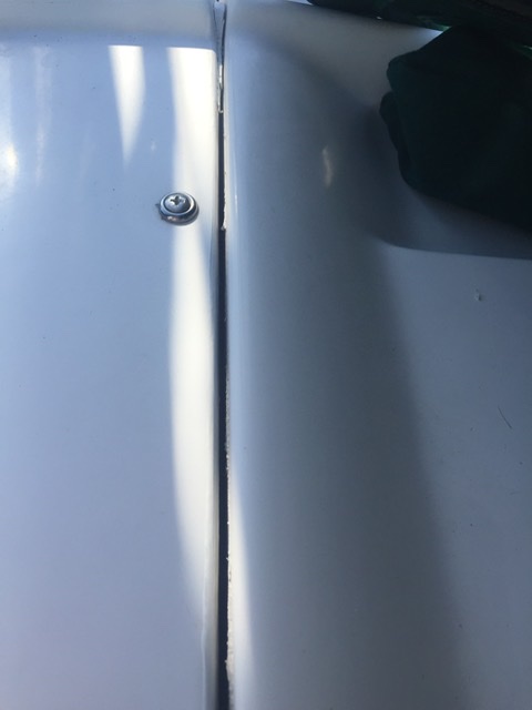

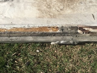

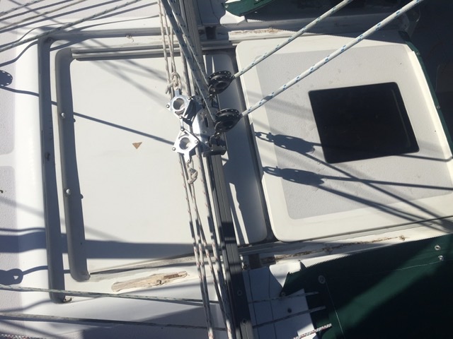

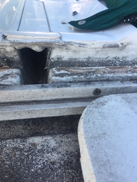

Today I removed the cover over the main sliding hatch. I am going to refer to it as the “Turtle Hatch”. Although I did not have any issues with clogged drains or water backing up. I could tell it was only a matter of time. There was practically no caulking left in the seams around the hatch. Any water on deck was bound to run down inside where there was said to be raw open wood ready to soak it up.
This project kept me up the night prior. But it has turned out to be non event so far. I would suggest all C350 owners to do this sooner rather than later. My boat is 17 years old. The calking is gone. Very good design by Catalina, other than not encapsulating the wood stringers.
The sliding hatch rest on slick HDP, so it slides pretty good. At the far end are two rubber bumpers to stop the forward movement. I bought bumpers today as close as I could find ($1.29). Mine are just old and not very pliable at this stage.

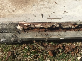

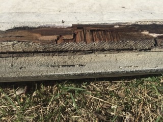

Contrary to what has been said in the forum previously, the wood on each side is an integral part of the Turtle hatch. My wood was not originally totally encapsulated. I doubt yours is either. On the port side there was lots more bedding compound applied about mid hatch. Apparently a puddle of water would get trapped between the bedding and the wood.The wood sat on top of that and soaked up water for years. That section is the worst of the rotten wood.
I dug out the rotten wood and am letting the stringer dry. Plans are to paint the wood with 50/50 mineral spirits and polyurethane. After it soaks up as much as possible, I will paint it with 100% polyurethane to seal it. I will clean any old caulking, replace the turtle hatch and then recaulk it.
The other option is to cut out the rotten wood entirely and either rebuild something similar or just leave it cut out. I am not that good at rebuilding. I could fill any empty voids with epoxy and micro balloons. I will see.
Anyways, I suggest everyone either recaulk the hatch today or remove, clean, reinstall and caulk it sooner rather than later.

- Seem with no caulking present
- 4FBDF2BF-4895-4591-8147-3726018F65DB.jpeg (37.93 KiB) Viewed 18645 times
- Looking at the channel where water sheds out
- EA1905E6-EB67-4F50-87C8-2B59490BEA41.jpeg (120.06 KiB) Viewed 18645 times
- Turtle hatch removed, area cleaned up.
- CBDEA488-A27E-43D3-8D30-0F0B45D72182.jpeg (93.29 KiB) Viewed 18645 times

Rotten wood close up.
- 83134221-DB32-437A-B971-92DC6EE70764.jpeg (43.64 KiB) Viewed 18645 times
- 48A1F611-3274-45EA-8486-97D1A5A8C36C.jpeg (43.68 KiB) Viewed 18645 times
- 107994A0-C947-4631-94E5-724D1D268E14.jpeg (43.52 KiB) Viewed 18645 times
Re: Companionway Hatch Cover Rotting
Many thanks for the pictures. although my 2003 has good caulking I am adding this to the winter list.
