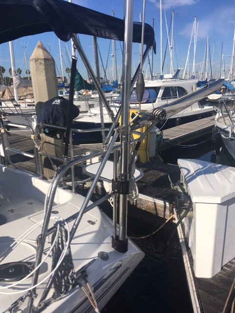

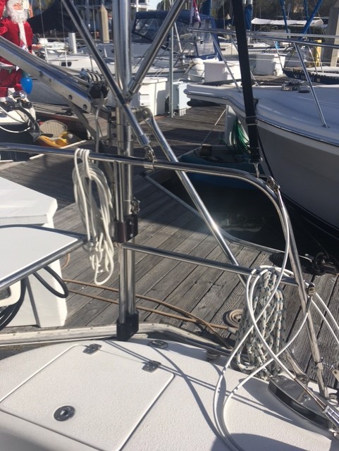

Here are a few pics of the radar pole if any are considering the add on. Part of the reason I went with the radar on a pole is that I wanted an engine lift as I tow my dinghy or tie it down on the coachroof and lifting the engine on to the dink when its a bit choppy is best done with some mechanical assistance. The Garhuer solution is a radar pole that mounts to the pushpit rails and has a support strut that projects forward. The pole came with an engine lift arm that is perpendicular to the pole with a 45 degree bracing strut. As is that will not work on a C350 as the bracing strut would hit the pushpit seat rails. With a bit of cutting and rewelding I raised the angle of the arm and put a dog leg in the bracing strut so that now the arm can be swung across the top of the seat and lifting the outboard off its mounting point is easy.
- engine arm1.jpg (96.92 KiB) Viewed 8147 times
- engine arm.jpg (104.18 KiB) Viewed 8147 times
