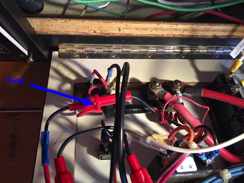

Dennis Ferriello definitely helped me. Had the same dead monitor issue. Dennis suggested I track down a fuse in the wiring bundle for the tank monitor. the fuse was blown and once I replaced it the my monitor came back to life and 2 years later have had no issue. The fuse was somewhat difficult to find behind the electrical panel in among all of the wires but an easy fix once located.

No there is only 1 fuse for the entire tank monitor. I wouldn't waste a lot of time looking for the fuse. If your display is working, the fuse is fine. If there's nothing on the display, then that's a good place to start.
- Posts: 690
Re: Tank Monitor for Waste Holding Tank
In case anyone needs to check this fuse in the future, here's what it looks like. Standing in front of the nav. desk and the electrical panel down you're looking at the back left corner of the panel.
