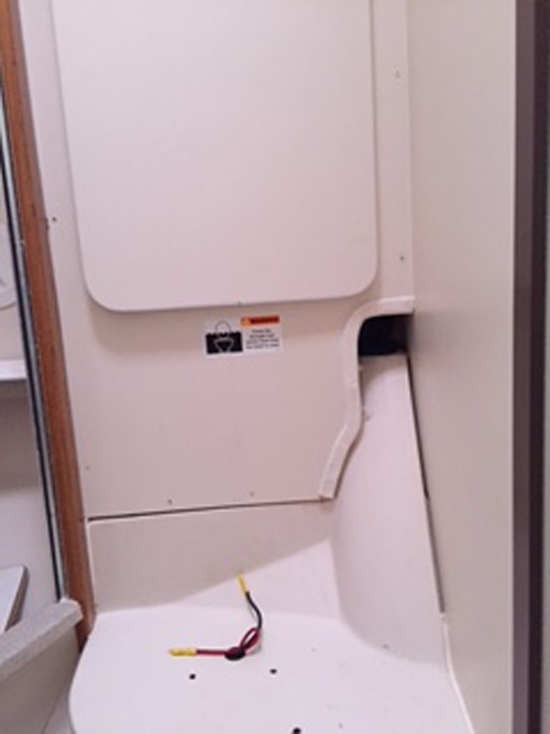

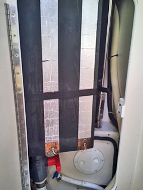

We replaced our Raritan SeaEra with the Raritan Marine Elegance toilet connected directly to the fresh water system. The toilet looks great, is quieter and works very well. The Marine Elegance toilet also has a salt water and fresh water/salt water combinations. We opted for the fresh water only as there is no odor & the water usage has not been a problem. The instructions were very good as was Raritan’s assistance. The only surprise is the fresh water pump runs whenever the toilet is flushed. I was able to eliminate all hoses from being visible.

Thank you - pictures are very helpful. The Elegance lack of visible hoses and motor is impressive, along with a less noisy operation. Couple of questions if you do not mind:
1. where and how did you install the "flush panel"? What cutting, wiring, drilling, etc was necessary? The Newport "flusher" is at the base of the toilet; does not require anything separate.
2. did you stabilize the new unit and if so, how? The Newport is glued down and wobbles until completely disconnected. Others have installed brackets from the "head closet" ( which is thicker than the base platform the toilet is attached to, so would assume greater stability and longevity) to the hinge portion of the toilet. Will "Elegance" be/become as wobbly as Newport?

HI Teri- I put the control panel under the head sink where the push button was located for the previous head - it required a small cutout. The wiring connections were very easy - but- fishing the wires to the connection locations required some thought. The head does not wobble as it is supported by a bracket fastened into the deck and then attached to the toilet. Each bracket is made for specifically for the toilet you receive. I made an opening behind the toilet to route the waste and water hoses(being in fresh water you may have a different hose arrangement). Ken Krawford also installed a Marine Elegance toilet. Hope this is helpful. I am happy to answer any questions, John

I'm very happy with the Raritan Elegance as well. John's help was invaluable for the installation. I'd highly recommend using Raritan's Saniflex hose. It's ridiculously expensive but bends without kinking. I also didn't realize how much odor had permeated my old hoses until the new one was in. The mounting brackets are a strange design I'd never seen before and I had to call Raritan for replacements twice before all was well. The unit is solidly attached to the base once installed.

Did you have to undo the waste tank to get
the waste hose to the top of the tank?
Also curious about fresh water source. I assume you can run a line from vanity sink. Did you have a source for the pex and plastic quick connections?

I installed the marine elegance not long ago also. No, you don’t have to unfasten the tank— at least I didn’t. On mine the hose connection is on the side of the tank. I have read that some released the tank to make easier access to the waste connection, but I didn’t have any issues. I had to extend the power leads from the old Wilcox-Critteden toilet, as well as the water line. The original W-C toilet was plumbed directly to the manifold in the bilge, but the line came up just slightly too short for the new toilet. Also, I didn’t reroute the hoses and hide them, I ran them through the same access as the original toilet. I did have to buy a couple of hose connectors, either a 90 or a 45, but I don’t remember exactly. We have been very satisfied with the performance of the toilet, and the customer service is superb.

Jeff, I didn’t have to move the tank. The Raritan hose is quite flexible and wasn’t too bad to position. I used nylon T’s and other connectors readily available from Home Depot for the supply side. I pulled my water supply by T ing into the cold water supply to the sink and shower.
