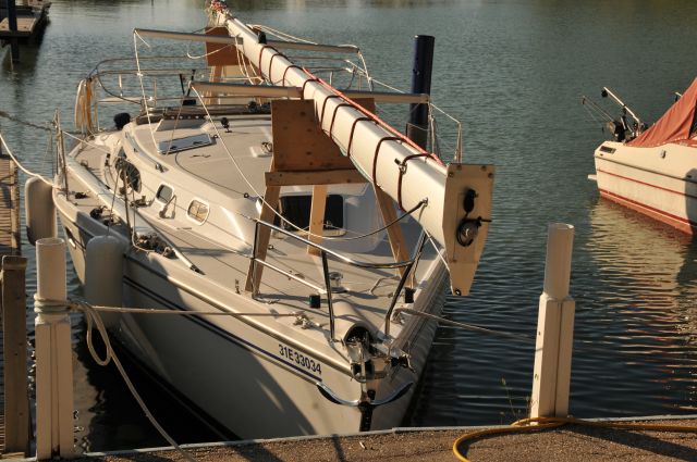

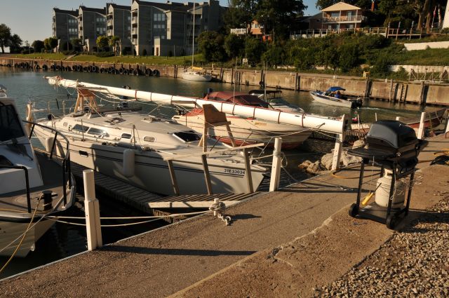

Hi Eric,
I built some supports last year, for winter storage on the boat. Attached are a couple of photos.
Kincardine_sept06 007_2.jpg (78.68 KiB) Viewed 15605 times
Kincardine_sept06 008_2.jpg (63.13 KiB) Viewed 15605 times

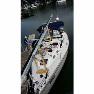

I went 450 miles with a similar rig down the TennTom and across 3 foot rollers across mobile bay with no problem I would suggest a middle support right in front of the dodger
Leslie West

What is not shown here is the aft brace over the Davit. It was not installed yet but I think you need three supports so that you don't bounce. And center the mast better
