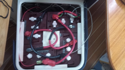

We did the conversion 4 years ago with an added start battery in the port settee, an 80 amp alternator, a Link monitoring system, a backup generator stored aft (Honda 2K), and as of yesterday, about 300 watts of solar. Can you tell I'm electrically obsessed? As I was playing with the solar panels yesterday, I noted the Charles was pumping max amps (30) with the fan running into a full bank of 520 AH. 14.7 volts was higher than I have seen previously and the batteries were bubbling vigorously. Since my wife had Achilles tendon surgery we haven't left the dock yet this year so I was worried we had a shorted cell or an over zealous charger. I found a very loose nut on the positive charger tab 50A fuse that, one tightened, seemed to restore normalcy. This setup has worked very well for us
- Our Trojan T145 solution with a central T lockdown
- Battery.jpg (54.6 KiB) Viewed 47349 times

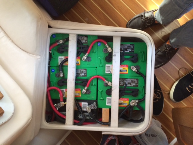

Re: 6V Golf Cart Battery Upgrade
Here's a diagram showing how I laid out my golf cart batteries and dedicated 12V starting battery. I combined all 4 golf carts to form 1 large house bank. I used welding wire (either 0 or 00) for the jumpers between each battery and standard copper lugs crimped on the ends.
- image.jpg (149.45 KiB) Viewed 47170 times

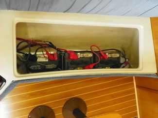

So now on the boat looking at the Batteries. 2 4d Replaced in 2016. I'm thinking about adding 2 6V Trojans to the Port Setee as well as a Isolated start.
Anybody have a picture if they put 6V in that setee... Did you use a shelf?
I know I'm a power hog, so need a bit more battery storage.
Rooster,
That is exactly the configuration that the previous owner of our boat created. No shelf, the battery hold down is a piece of aluminum angle with a long bolt through the base of the settee that I believe you can see in the picture below (repeated from an earlier post in this thread).
