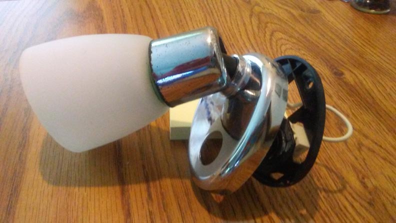

The wall mounted light fixtures are removed by popping the chrome base off with a thin putty knife or similar. Once the chrome base pops off there are 2 screws holding the mounting base to the wall. Below is a photo showing how the fixture comes apart. (converted to a JPG image before uploading).

Gary and Janet - Thank you so much! Very thorough and helpful advice and I appreciate your generous offer. I'll likely just replace the one fixture with the original type (or just the switch - I'll send you a PM) since the other fixtures all look fine at this point and we haven't had any concerns about them not being bright enough. (I believe there are LED replacement bulbs available for the original fixtures, which I likely will order; I've already put LEDs in all the flush mounted cabin lights.) Thank you again (and for the tip on converting pics to JPG).
