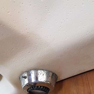

Good afternoon we are under contract on a 05 350 and I have noticed some discolration (yellowing) of the headliner in a few spots mainly around interior salon lights. Does anyone have experience with these marks I will attempt to upload a photo thanks in advance.

Hi, I am the original owner of a 2005 and the discoloration started after about two years. Catalina never responded to my questions to resolve the problem so I have been cleaning the areas with acetone which works well but do occasionally come back. If you notice most areas are also sticky. I assume that the resins in the coach roof were not properly blended during manufacture and by using the acetone the resins will eventually cure and the discoloration will not recur.

I have found that Mr. Clean MajicErasers and lots of rubbing will take off the discoloration without the bad effects of acetone. Wipe well with a wet rag and follow with wet rag often.
I will report later as to the long term effectiveness.

After 4 months since using Mr. Clean erasers to rid head liner of brown spots, I can report that the stains have NOT returned.
