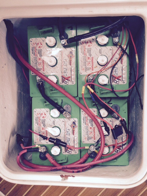

reviving this old post as I had a similar experience over the weekend.
over last couple of weeks actually smelled rotten onion like or egg smell .. could not find where it was coming from.
this past weekend happened to check battery compartment of my 2 brand new (less than 6 weeks old) 4D batteries and noticed something that looked chard on floor of battery compartment so got to moving things around and there was about a 6"x4" hold burned in the bottom. Electrician says battery acid is the culprit, no signs of leakage from the new batteries on top or any evidence.
1. I thought battery lockers were supposed to be contained and not react to battery acid leakage - has anyone else experienced problems with the construction of their battery locker forward of the nav desk ? It does have fiberglass but a very thin coat apparently. The fix for us... we made sure that there was no more damage other than to the veneer under the batteries and cut a thick piece of starboard and sealed up the entire locker trying to make a proper battery containment locker.
2. do you have your 4D's in battery boxes inside the locker ?
Ok battery locker now hopefully is all non reactive to acid if more happens to leak out but why.... never had this problem before so checked charger and it kicks on and then goes to float.. all good.
cranked the engine and tested charge from alternator... all good.
tested both batteries.... the right way ... all good
Onion / Eggy smell is not gone yet but hopefully it will dissipate
Clueless on the gulf coast... ideas ?

Yes all good on levels. I check them and had electrician also look to make sure I did not miss anything
Any comment on the battery box construction. Has anyone elae had problems or had to construct or amend the batter locker

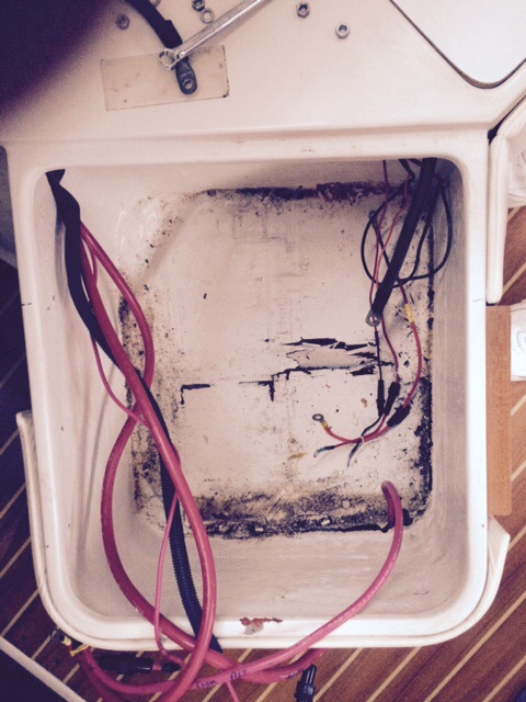

Air Mobility
- Joined: Sun Apr 01, 2007 7:57 pm
Battery Box Failure
I just got finished making some temporary repairs to the battery box. My wife and I have been out for almost a week now and had to spend a day in Oxford,Md to recharge the batteries and dry out. I was about to check the battery electrolyte level when I noticed the one of my four golf cart batteries was not level with the other three. Further inspection revealed the battery box floor had caved in on the aft starboard side of the box. I got a piece of plywood cut at the Oxford Boat Yard (gratis on a Saturday) and screwed it to the battery box floor until I get back to Rock Hall. You may want to check this area. The construction is minimal, thin fiberglass over plywood. The whole floor will have to be replaced. I'm disappointed in the construction in that area.
