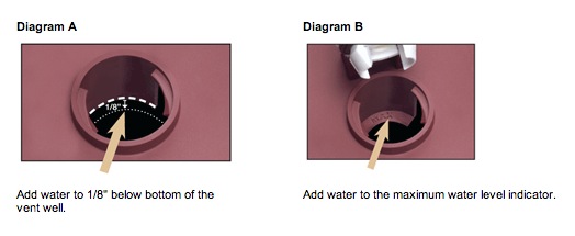

Ken (or anyone) , what's the best procedure for measuring the actual liquid level in the battery and where it actually should be relative to the plates?

Duncan I've asked this same question to several battery dealers and can't get a definite answer. Obviously, you don't want the plates exposed. Toward the other extreme, if you notice liquid (ie acid) on top of the battery around the fill holes, you've over filled. This results from the bubbling of electrolyte that occurs during charging and excess fluid will escape from the vent holes. Here's a picture of how to fill a battery but the construction of yours may vary.
- Screen shot 2013-07-26 at 6.42.23 AM.jpg (27.4 KiB) Viewed 17186 times
