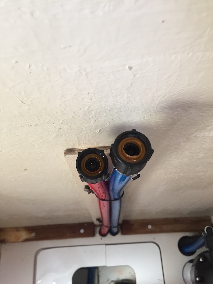

We noticed that the hot water line into the sink is not an identical feed as the cold water and assuming that the pressure for the hot and the cold are the same reasoned that it must be that the positioning of the hot line is why the hot appears to be problematic. The blue cold water line is held perfectly straight vertically by the wire tires and has a slight bow/bend to starboard in it toward the top near the barb. When the faucet is on, we noticed the blue line actually moves starboard and then back to resting position in center. The red line does not seem to move at all under usage.
When our hot/red waer line came off by itself we inserted a male and female galvanized metal extention consisting of a 1/2" steel pipe nipple and 1/2 inch coupling and cut the line short to fit. We were sure to use the teflon tape with two complete rotational wraps. This is because the first two times it leaked. Additionally we used two hose clamps, tightened at the top of the hose on the barb. It still leaked.
The trouble with the hose clamps is that the barb narrows at the tip and the tightest clamp has to be the top clamp. Working in such a small space was challenging but the largest problem seems to be fitting the hose back on the barb. We are still working to get it all the way to the end of the barb.
Never-the-less, the hot/red still works its way off and leaks. We are going to separate the red and blue lines with their own individual wire ties that hold them upright. Also will add addtional wire ties to hold them up higher, as close as possible to the barb.

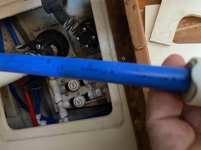

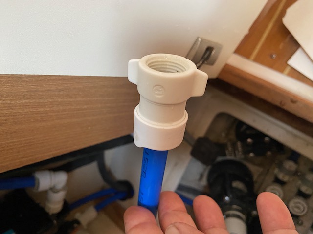

Hey Jason. Did you ever find this connector? I have a similiar problem. After commissioning the boat from the winter storage and filling the water tanks, the conection under the galley sink for cold water feed from the stern tank broke. I'll try and attache photos, but if you found a place to order/obtain the, can you let me know? Basically I need exactly what you have the connector you have in picture (female on one end to connect to the inline shutoff and the other end ridged to slip into the hose from tank)... I'll try and attach pix...
