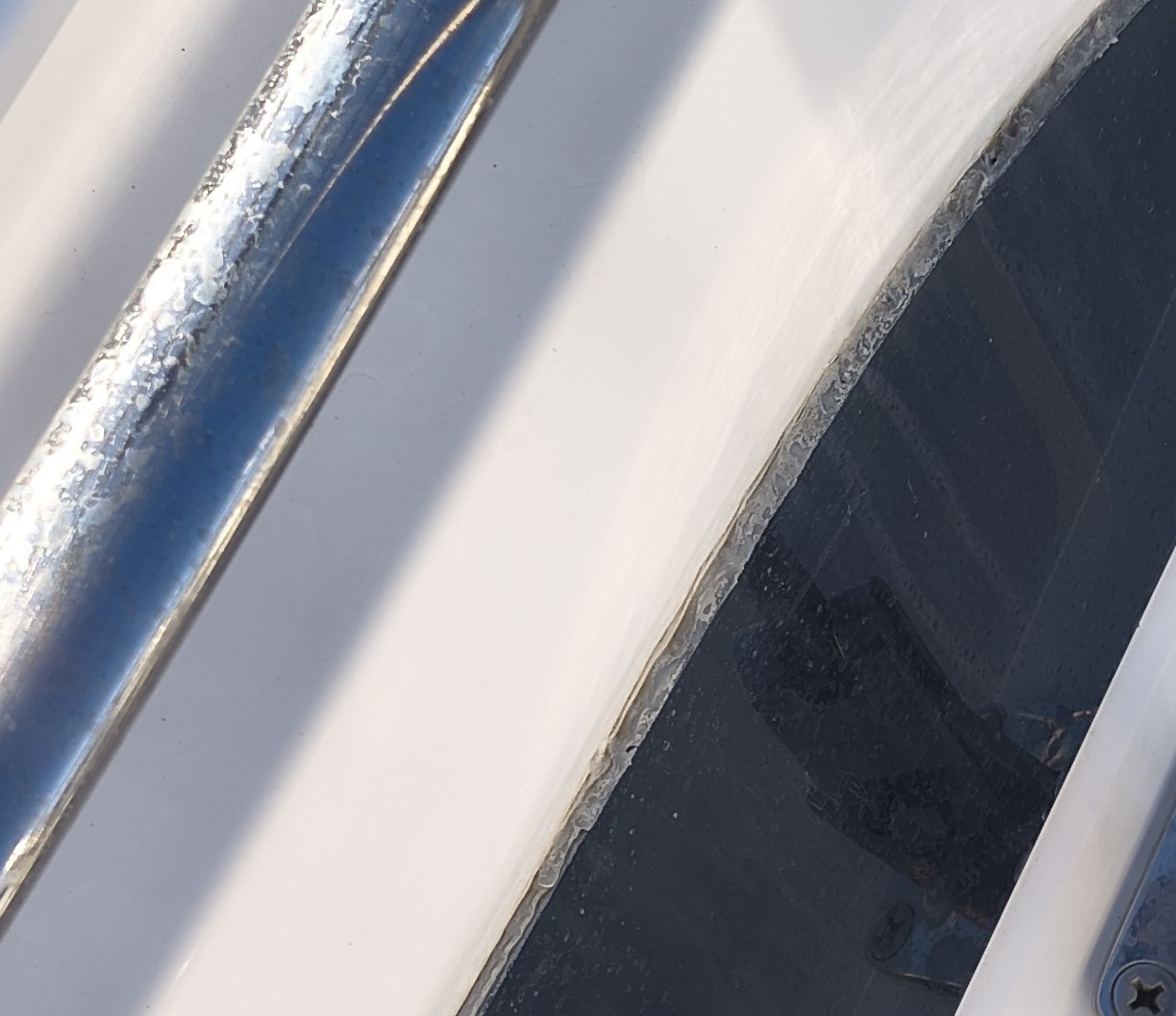

After 26 years the bonding silicone on my "sun exposed" side windows has failed and they are leaking. Trying the easy way to seal with Sikaflex 291 didn't wokk as it didn't stick to the acrylic window so I am now preparing to remove the windows fully and do the job properly.
It appears that use of double side Very High Bond tape is now in routine use and potentially a lot less messy than bedding the window against a bead of silicone. Has anyone used VHB tape and how did it go?

If I'm reading this correctly, I had the same problem about 10 years back, leakage from the top of the largest fixed widow on the starboard. I was about to pull the window out and reseal with a new complete install and someone in my marina suggested .....stick something slim in and lever the window slightly to enlarge the gap then clean the mating surfaces as best you can and apply in the gap clear 3M silicon. I did this and made sure I had plenty to cover the top of the join to prevent further ingress. This seemed to fix the problem for about 30 minutes work. I haven't had a leak again since then, I'm mindful I may have to go back one day and remove completely and reinstall but for now it appears to be a sound and effective solution.

Well that is pretty much what I did except didn't lever the acrylic out far enough to attempt to clean the mating surfaces, I applied Sikaflex 291 same way you did and thought "job done" but within a few weeks the acrylic and fibreglass/old sealant bond had failed totally. Nice new layer of sealant on the cabin side though!!
