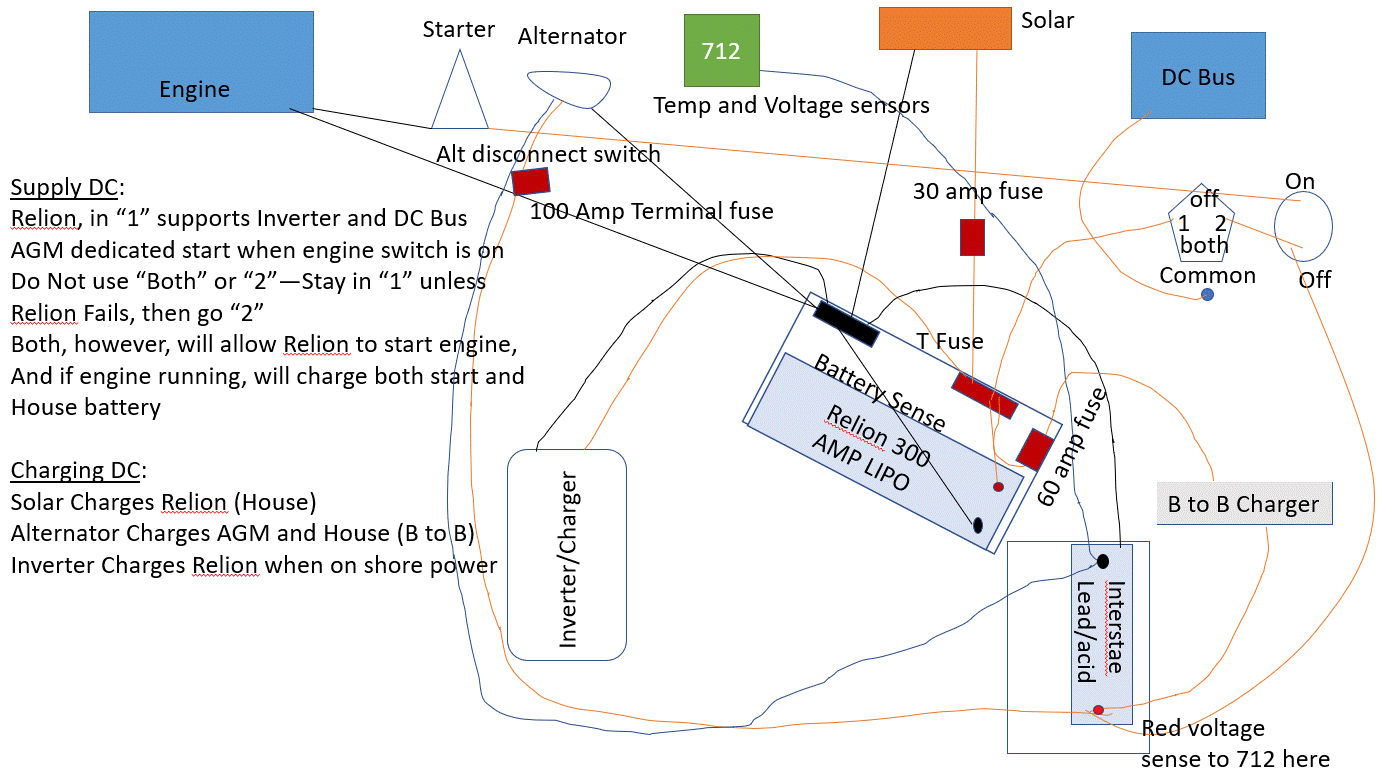

In our 2006 350, the alternator positive is wired directly to the ON/Off Switch. My LiPo battery easily fit where the AGMs were--under the seat next to the Nav table.
Marine-How-To recommends you wire the alternator direct to the starter battery to protect the diodes from any inadvertent switch errors. Attached is a basic drawing I initially used to understand/map out the DC engine/battery wiring system. My objectives were to 1) Put in a 300 AMP LiPo house battery, 2) Protect the alternator 3) Leave as much as the original wiring in place as possible.
This setup allows me to use the Both1/2 switch to connect the Starter and House battery by selecting "Both". It allows me the option to start the engine if the starter battery fails. If you do wire the alternator direct to the starter battery, place a placard in the engine compartment so anyone working on the engine is aware the alternator is "hot" despite the position of the ON/OFF switch.
