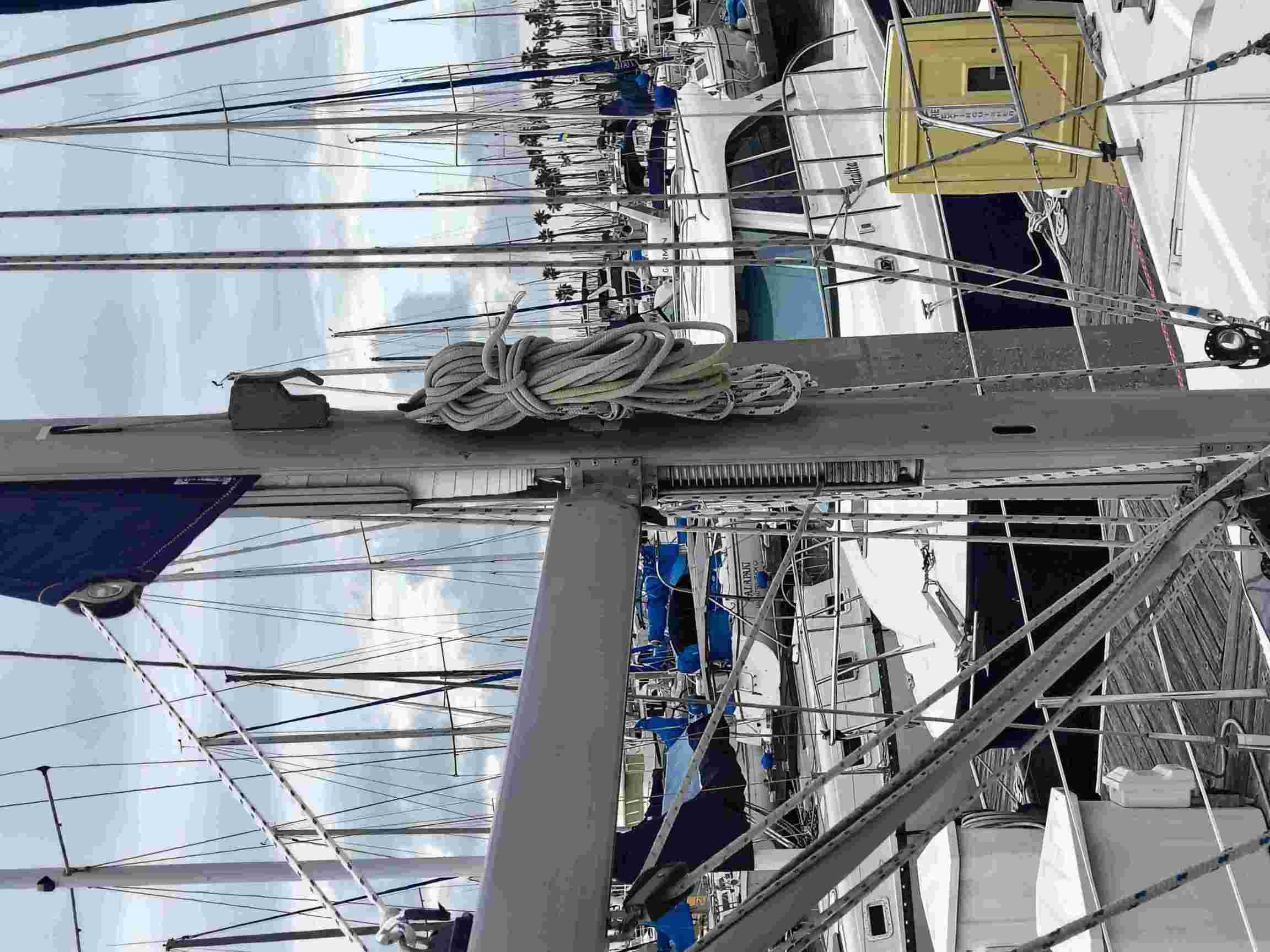

But I have a follow up question re the inhaul and outhaul. When looking at this closely I see that its time to replace the inhaul and outhaul lines.
The outhaul is straightforward and I did that today, but is the sequence for the inhaul..... as described in the charleston spar manual and repeated here after some head scratching.
1) Remove the sail (again!)
2) This will mean that the sail is in the fully out position and the inhaul line will be at the top of the screw (not nearer the bottom as per my pic)
3) Loosen the locking bolt pull the retained end out and spin the screw to remove the old line.
4) Clean everything blast the bearings with fresh water
5) Secure the new line to the lower locking bolt, spin the new line on back to the top position where the old line is as per step 2.
6) Pass the free end back through the pulleys to the cockpit (I may secure the lines old/new with tape and pull through?)
I have checked that I can break the holding bolt free ( I sprayed it with WD40 a day or two ago).
Anybody done this recently? Is there any way to do this with threading the line in and around the screw eight times and hence not removing the sail again? Should I join old/new at step 3 and spin the new on as the old comes off?
Any thoughts, comments, or cautions?
